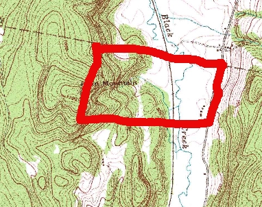

Newbury, you got some pretty nasty terrain there, need a helicopter to get around that patch of woods. Maybe that's why you moved to Mississippi?
And I messed up my drawing, I've been up for FAR to long.
Actually I'm going to move to Mississippi because of my wonderful wife. Her family's down there and I'm working on getting a full square mile of property.
