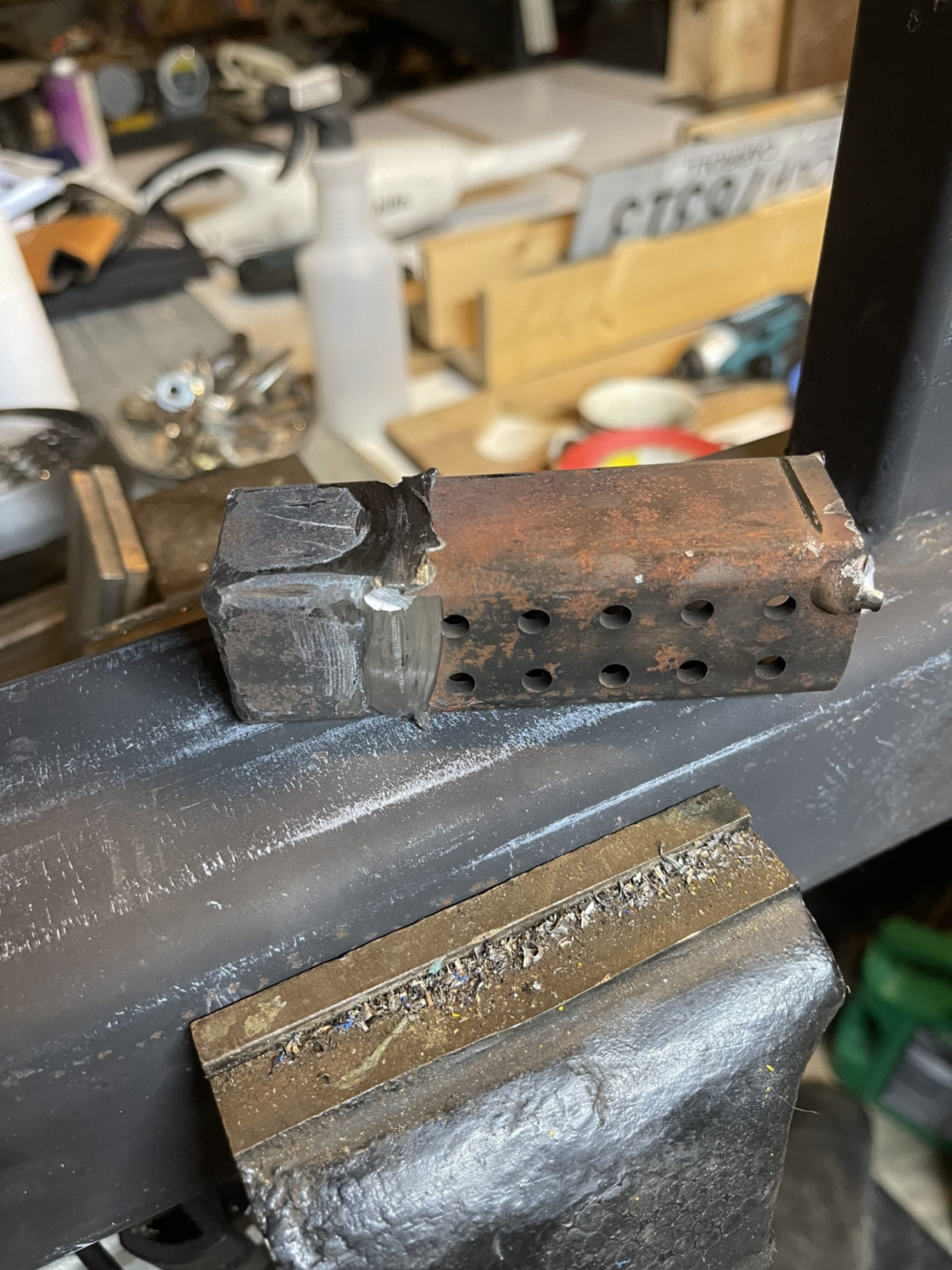

I had to know what the inside of the muffler looked like. So I Cut the PT425 muffler apart to see the internals
Will make some modifications to allow more flow
I already drilled out the manifold that was
mis aligned,
I will say, it was all welded up good. LoL

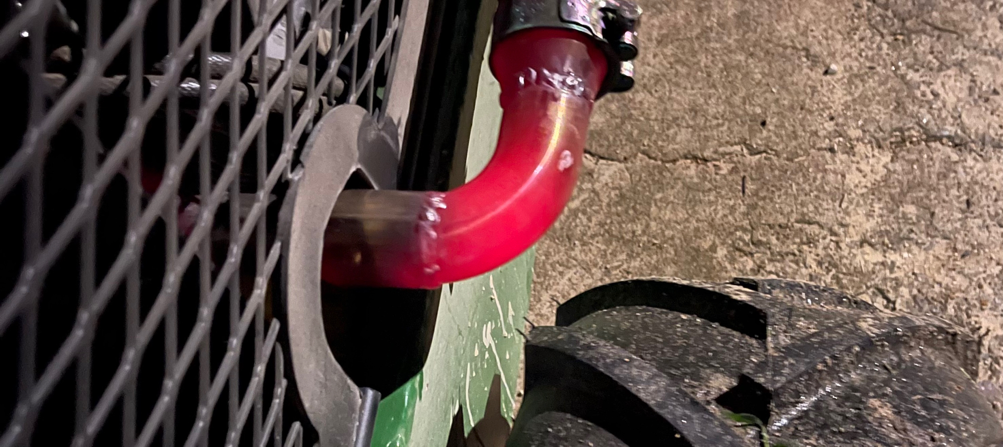

Put on a factory Kohler exhaust manifold to a stainless 1.5” elbow, and a junk open pipe motorcycle muffler
It still glows red at the elbow
Which is exactly what Terry told me would happen
So the hot exhaust isn’t caused by a restriction
Everything on the engine checks out, and it’s only at 13 hours
but I still don’t think this is normal
Note:
This pic is taken at night, just looks bright due to camera flash

I've never had or even seen a PowerTrac, but as a mechanical engineer with a day job of dyno testing internal combustion engines, I will add my 2 cents.
That is not normal. Your exhaust gas temperatures are clearly way too hot, and that looks downright dangerous.
Sure, on a dyno torture test we can also get entire exhaust manifolds, turbos, and exhaust pipes glowing bright red here at work. But thats at sustained peak power conditions on highly boosted engines. A naturally aspirated Kohler 2-cylinder loafing around should not be anywhere near that hot. The only time I would call that acceptable is after a full hour of dragging a plow through soil on a hot summer day, or similar punishing work.
Multiple things can cause excessively hot exhaust gas temperatures. But ignition timing is an obvious suspect, valve timing another. Exhaust restriction would be also be one, but looks like you already answered that question. I know it would be obnoxiously loud, but did you try running with no muffler at all, just to see?
