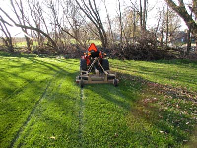

I like the side discharge decks. My first tractor had one, and now I have two on my current tractors. One thing the side discharge does is allow "raking" the leaves in the Fall...........chim
