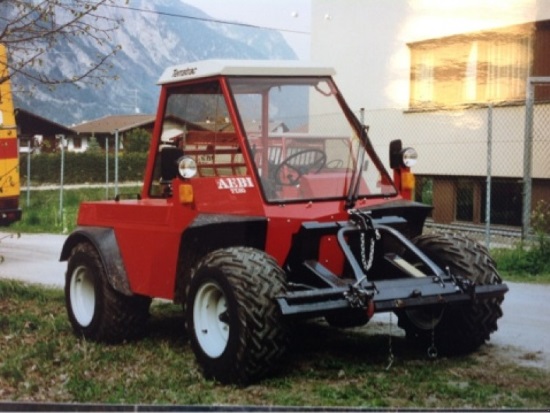

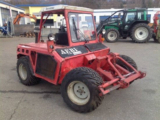

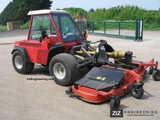

/ Side Shift for Three Point Hitch? #6
Here is a side shift front 3 point.
And the rear fixed 3 point.
Where do you find this stuff? That looks like a slightly different take on the front 3PH where the top link attachment point appears tied to the lower lift arms.
/ Side Shift for Three Point Hitch? #8
Several years ago I saw one on eBay, saved some pictures and went to their Website.
When I saw the title of your thread, I remembered it.
/ Side Shift for Three Point Hitch? #9
The Terratracs with front side-shift (pics in post #6) don't look to have the front PTO, have chains dangling from TL 'bases' and apparently quick links at the end of arms unlike the rear draft arms in the 3rd pic. Used for 'shunting'/parking/palleting implements, those two?
btw, Kubota power in (the smaller hp, 50, 72) AEBI's of late, nice cabs, & lights. Of course there's no price list just 'out there'.
AEBI Terratrac TT211
New Equipment | AEBI New England, LLC
Kinda have to clear the rear tires to keep draft arms from rubbing, no? .. so everything behind the tires, more or less? (Didn't catch how much shift (in, ft) or what implement.) Shift all 3 pts or the shorter top link would cause tilt at extremes. That said, could be plumbed as tho' a top or tilt cyl, ... or I'm just up too late.
The AEBI is an amazing piece of machinery. It looks like the front "3PT" pivots up and back rather than a somewhat near parallel lift as we normally think of a 3PT.
