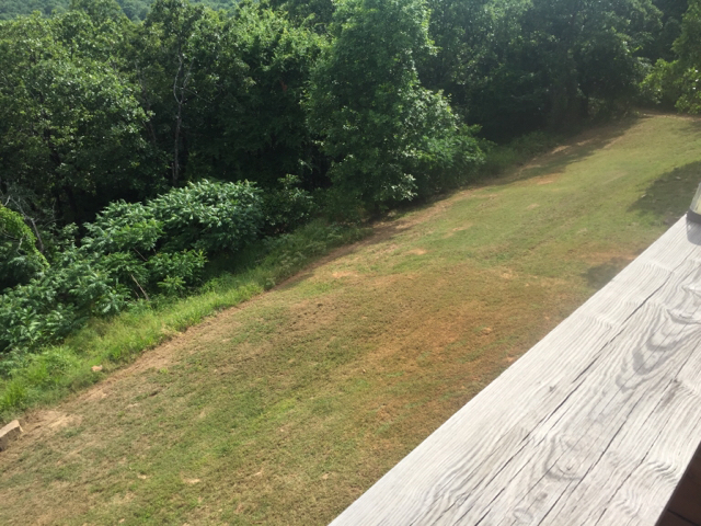

I usually mow it with a Toro Self propelled push mower.
I Tryed a ZTR. That was a disaster for cross slope mowing.
I don't plan on doing something stupid. I think that with the right setup, it can be mowed with the L3301 dry and slow.
It doesn't bother me to put spacers in and I'm also open to hanging some permanent weight under the tractor to lower the COG.
It appears to be doable with the correct setup. I wanted to find out the most bang for the buck options from those who know how and work down that path. As I have learned here, wheel weights which I first thought are really not going to be a big help.

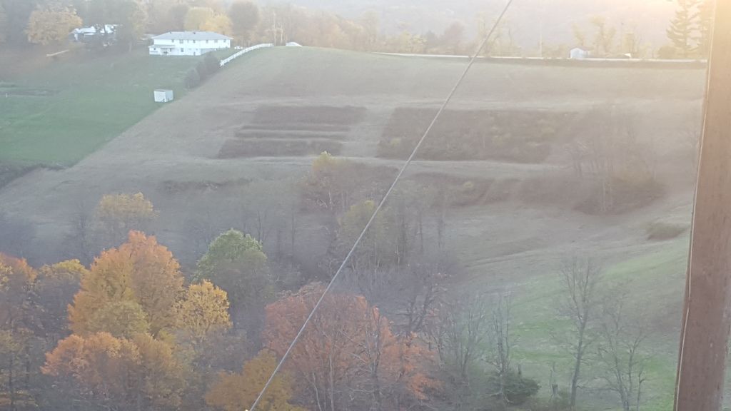

I cover 20° to 30° slopes sidehill with my 3005. I have loaded tires all around, and 4.5" spacers on each side on the rear. 20° is no sweat, normal on my farm. 30° is slow, butt-pucker going... but possible for my set up, but it may change now that I added weight up high when I built the full cage ROPS over the winter.
This is about 20°
Some of these slopes hit 45°, which is my max going up and down.
I carry a 5' section of railroad track in my loader bucket for front ballast, with the 5' brush hog out back it is well balanced. I keep loader low as possible.

Mowed it today. After taking FEL off and slowly traversing it, tractor never felt "tippy". At the worst part it seemed the tractor may want have a slight tendency to slide rather than tip.
I'm watching for some weights that I can add underneath the center eventually. Thanks for all the information. It's nice to actually know it can be done.
