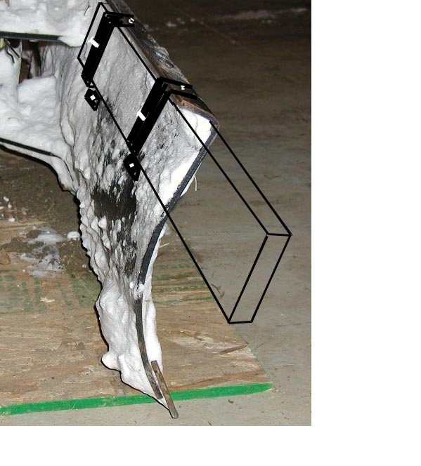

A wing (sorry no pictures) that I built for a plow like a rear blade was just a wood 2x6 that would extend the top half of the blade out to the side. This would not clear the snow below about 4 inches, but would move the windrow of snow out away from the blade so it did not slide back down onto the plowed area. The 2x6 was in brackets behind the plow that would allow it to slide back out of the way and could be pinned in either position - out or in. Worked very good. There is less stress and strain keeping the snow moving that is already moving in that direction. The wings on most road plows are used like that, to just roll the snow in the windrow back away from the roadway.

Beenthere,
Any chance for a pic?? Not sure what that would look like.
Kevin
   / Side wing on a snow blade? #14
Post a pic of your blade, and I will draw in the setup I used to have. Don't have it anymore, so can't post a pic for you.

   / Side wing on a snow blade? #19
Knight9
I touched up your photo with the approach I found to work well for extending the reach of the blade, at least for moving snow further back so it didn't fall back into the path the blade had just cleared.
This could be a bit out of scale, but the idea is to have two brackets that capture a 2x6 or 2x8 behind the blade. Removable with a couple pins.

Beenthere,
Thanks for taking the time to draw that up! I appreciate it, and can see now what you were describing. Certainly worth a look.
