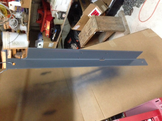

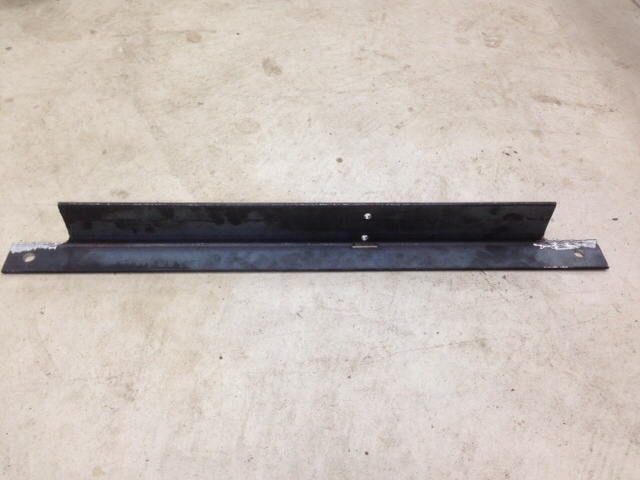

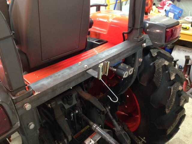

I've been wanting to add a real sized toolbox to my Kubota Grand L 3540 for some time now and have thoroughly enjoyed researching all the unique and creative ideas people have come up with for adding additional tool storage to their tractors. I wanted to leverage existing mount points on the tractor as well as keeping the design relatively simple, yet functional. I haven't seen this particular approach done before, but I can't imagine I'm the first one to come up with this idea. I started with a piece of 2"x3" angle iron and had it cut to fit onto the ROPS where they mount behind the operators station. Since I often travel on the local roads, I needed to incorporate the SMV mount into the design, so I also had a slit cut in so I could mount the bracket behind where the new toolbox will go. image-2858034732.jpg image-3932339490.jpg image-1586937327.jpg image-3090045696.jpg

Now that I have everything test fitted, I'm going to paint the new bracket to match the ROPs and hopefully by the time I have the paint job done my new 20" tool box will arrive. I'll post some pics of the finished product in a few days so you can see how it turned out. I'm really looking forward to the additional storage!

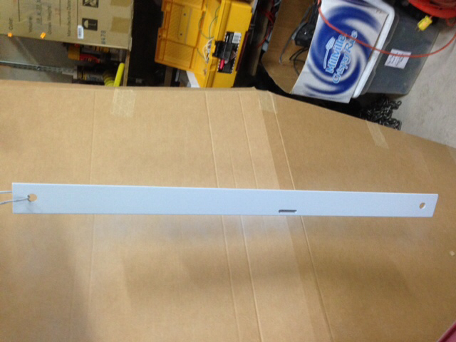

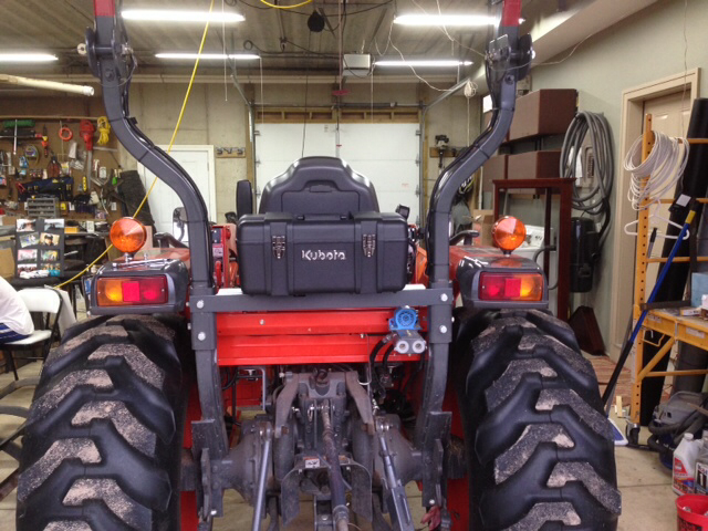

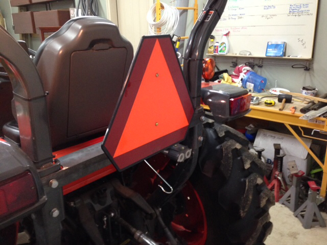

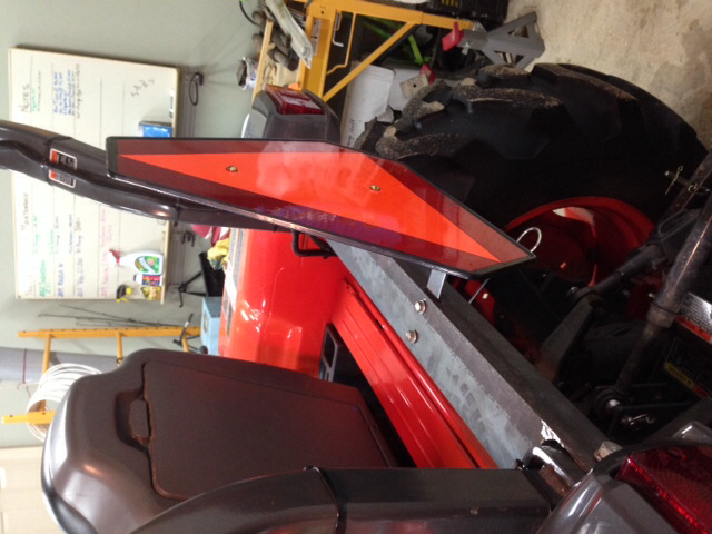

After putting the SMV sign back on I wasn't happy with how it blocked the tool box. After further examination, I discovered additional mounting holes at the bottom of the factory tool box (if you could call it that). I had to make up an extension arm for the factory sign bracket, but it was pretty straight forward. Found a piece of matching width and thickness metal at the local hardware store, drilled some holes ..... 2 coats primer, 3 coats ROPS gray and back in action.
Also added some reflective tape to dress it up a little. Here's the finished product.
