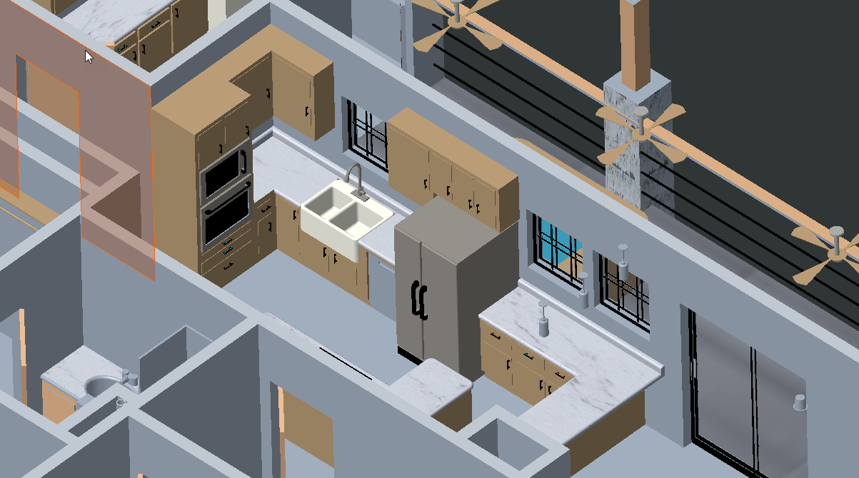

I got much more serious and ended up using Chief Architect to design and make prints for my house and shop build. Nowadays it costs close to $3k, so I doubt that is an option you want for this, but I know they sell a stripped down version called Home Designer for anywhere from $100 to $500 depending on version. They also allow you to download trial versions, so you can give it a whirl before you commit. I cannot honestly say if the Home Designer series compares well to their flagship Chief Architect platform, but the higher end stuff was clearly good and very powerful, so I would expect the simpler versions would do what you want for a simple shop and carport. They do make Windows and Mac versions too, so that may be a big deal as I don't know how many are available for Mac. No connection to them other than a user (well, mostly a former user as I haven't touched it in a few years at this point). Download the trial and see if it does what you want. They had a lot of training videos for the flagship product, but charged extra for them. You might find some on Youtube for the DIY series.
Chief Architect's (or Better Homes and Gardens) lowest end program Home Designer Suite is super easy to learn and use. It does a great job and it's cheap. It actually designs in 3D when you're drawing in 2D.
It gives you a simple material take off, if you create your design accurately. I used it to design one of my cabins (16'x16'). I then exported the design to AutoCAD to tweak it to exactly what I needed.
Here's an example of what your 2D drawing in Home Designer Suite would look like;
And here's an example of what that 2D drawing looks like when switching to the 3D view;
Lastly, here's a simple export of the materials list to a text file;
as well as a screen shot of what the materials list looks like in the Home Designer Suite program;

Thanks for posting this! I first downloaded a trial and then bought the Pro version of Home Designer. $495 was bit spendy, but I love the program and the video library/article database is fantastic. It has been a lot easier for me to grasp than expected. Unfortunately the program has exposed some inadequacies in my computer, but I'm not quite ready to shell out three grand plus for a machine that meets their specifications.
