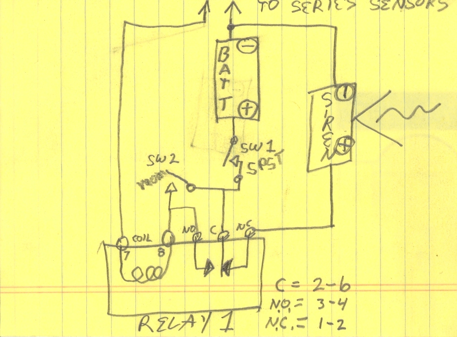

I built a simple alarm years ago and so I just drew it up from memory and built another one for my friend. It is a pretty basic system, easy for DIY. It is intended for when someone is close enough to hear the siren but could be easily remoted with a radio link. One version I helped a coworker install in his car, paged him if the car's security was compromised. That was sufficient for him because he was within a few hundred feet of his car (but out of sight) when he was concerned with theft.
Anyway I am attaching the schematic for a simple version.
Circuit description:
Batt: I used an old 12 volt car battery but could be a lot smaller, a motorcycle battery or starting battery for a lawn mower or...
Siren: I had an old 12 volt DC motor driven siren but you can buy an electronic siren cheap or use an inexpensive air horn from Harbor Freight or J.C. Whitney. Any 12 volt DC operated noise maker is OK if it doesn't exceed the current rating of the relay contacts.
Relay: The relay I used this time is a DPDT 12 volt relay with 12 amp contacts. A SPDT relay would do fine. I wired the contacts in parallel to get more current handling in case my buddy want a real kick butt noisemaker.
Switch 1: is a simple on/off switch SPST. I used a labeled toggle switch but a $0.69 light switch from Lowe's would be fine.
Switch 2: is a momentary contact SPST switch, essentially a doorbell button.
The other component (not shown) is a battery maintainer which are often on sale for way under $10 at Harbor Freight. By using a battery the alarm system can not be disabled by turning off the AC power
The arrows labeled "to series sensors" in the schematic drawing represent two wires that go to the sensors which are all wired in a "daisy chain" like cheap Christmas tree lights. YOu can put a few nails around a window opening and zig zag some small gauge wire across it. This constitutes an effective window sensor. If the wire is broken the alarm sounds. Restoring the wire does not stop the alarm which runs till the battery goes down (can be several hours) or the alarm is turned off.
You can buy magnetic switches with an accompanying magnet to put on the door and door frame so if the door is opened the alarm goes off. Again, closing the door does not shut the alarm off.
How does it work?
When it is wired up and installed with the series sensors you arm it by pressing and holding down the momentary contact switch (door bell button AKA Sw 2) and turning the Off/On switch (SW 1) to the On position and then release the push button.
The alarm is now armed and the little current draw of the relay coil is flowing in all the series sensors. If a sensor is "violated" this interrupts the current through the relay coil and it de energizes which lets the (C) Common contact of the relay touch the NC Normally Closed contact which puts battery power to the siren until the battery runs down or the Off/On switch is turned off. There is nothing that can be done to the sensors that will shut the alarm off, a desirable trait.

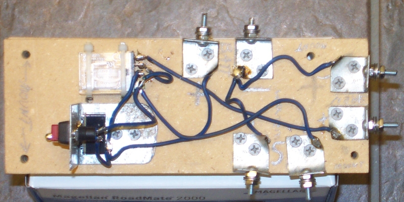

For picture oriented folks I am including a snapshot of a rapidly tossed together version that cost about $12 because I used "nice" switches. The rest is crude home brew with parts made from scrap galvanized sheet metal. Galvanized is handy because it solders easily.
This little scrap of MDF holds the switches and relay and has machine screws to hook up the battery, sensors, and siren.

Patrick:
i believe that you need a jumper wirer from the normally open contact back to the coil to HOLD the coil in while the juice continues back through all the safety wires on the doors/windows. the jumper wire is used to maintain the coil power . I'm sure it was a simple omission on the drawing only.

I built this one from the wiring design that I posted and it works. I will take a look and either comment on your "fix" or explain why a change isn't needed. Thanks for looking it over. It wouldn't be my first mistake.
Well, I looked over the drawing and it is what I wanted. It works as drawn and has been delivered and demonstrated successfully at the customer site.
To reiterate the sequence of events. First, of course, you ensure that all the daisy chained series connected normally closed sensors are closed. Then you press and hold the momentary contact switch and while holding the momentary switch down yo turn the off/on switch to the on position and then release the button (normally open momentary contact switch)
As a practical matter the current through the momentary switch is in parallel with current through the siren so the siren runs just a very little bit when the off/on switch is first turned on but when the relay energizes because the momentary switch provides a current path to energize the coil the path for siren current is interrupted when the relay energizes.
If I left you in the dark (sometimes my explanations are not the clearest), please ask a specific question and I will try to answer it. The circuit does work AS DRAWN and AS BUILT and are the same.
The push button provides a temporary shunt around the NO contacts of the relay to power the coil. Once energized, the NO contacts provide current to keep the relay energized until a sensor goes open. Of course the de-energized relay lets the NC contacts turn on the siren until the off/on switch is turned off, the battery runs down, or the cows come home.
The little shot of siren when first "set" is mostly a function of the "soft" battery substitute I used (small battery charger) which is pulled down by the starting surge and causes a brief delay in energizing the relay which shuts the siren off. It is just a small fraction of a second. With a real battery for power (pretty stiff source) it is likely the motor driven siren will hardly spin any if at all. If an electronic siren is substituted for the motor driven one it will probably just make a click sound when the system is set.
Pat
/ Simple cheap alarm design. #5
Spiker.. it's a simple 'latching' relay design.. the circuit appears to function as drawn, IF the lines going to the series sensors have continuity and the main spst on/off switch is on, and you hit the momentary button.. that causes the relay to engage, because the common relay contact, fed by the on/off switch is carried over to the coil thru the NO contact, the relay is latched.. IE.. it's own actuated contacts are feeding power to the coil.. this circuit trips ( unlatches ), when the path to negative ( sensors ) are cut. ( for a glass window I'd use foil tape.. for doors.. I'd use magnetic switches.. etc.
Once the circuit unlatches, the siren is powered by the battery thru the NC contact and the common contact, and can only be reset by reconnecting the sensors, and then flashing the coil field with the momentary SPST switch... causing the relay to once again latch.
And spiker.. you may need to have them glasses checked.. the NO contact is tied to the coil line #8, while #7 finds (-) thru the sensors.... in this diagram.. no jumper wire needed...
