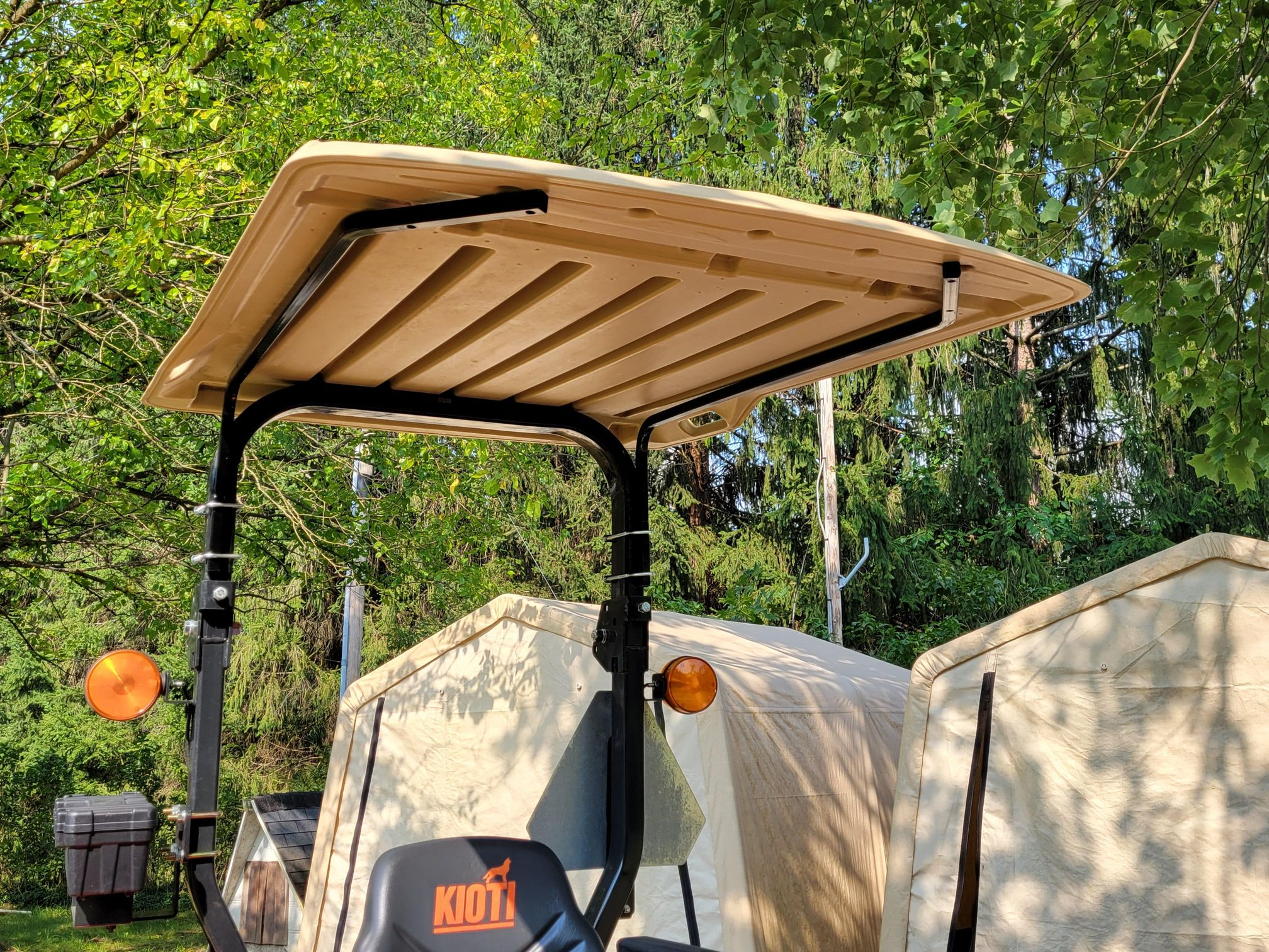

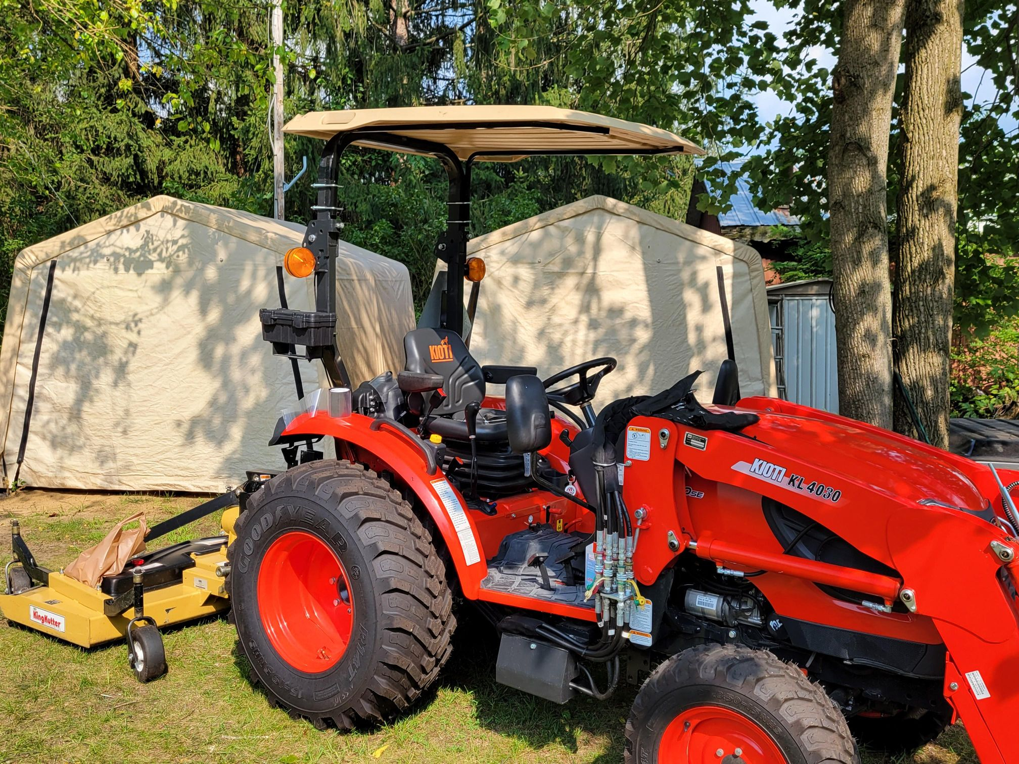

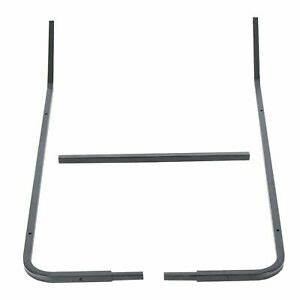

Finally found a decent price on a EZGo canopy locally, and got a hold of a 3 piece front bar kit for the same. A little chopping, u-bolts and some Flex Tape (for anti-rattle) and a nice little removable canopy is born. Not done done as some cleaning, painting, and final bolting needs to happen still, but pretty much done with the mock up.
(I resized the pics to pretty small, but still looks big when posted, sorry about that)
Bar kit started like this:

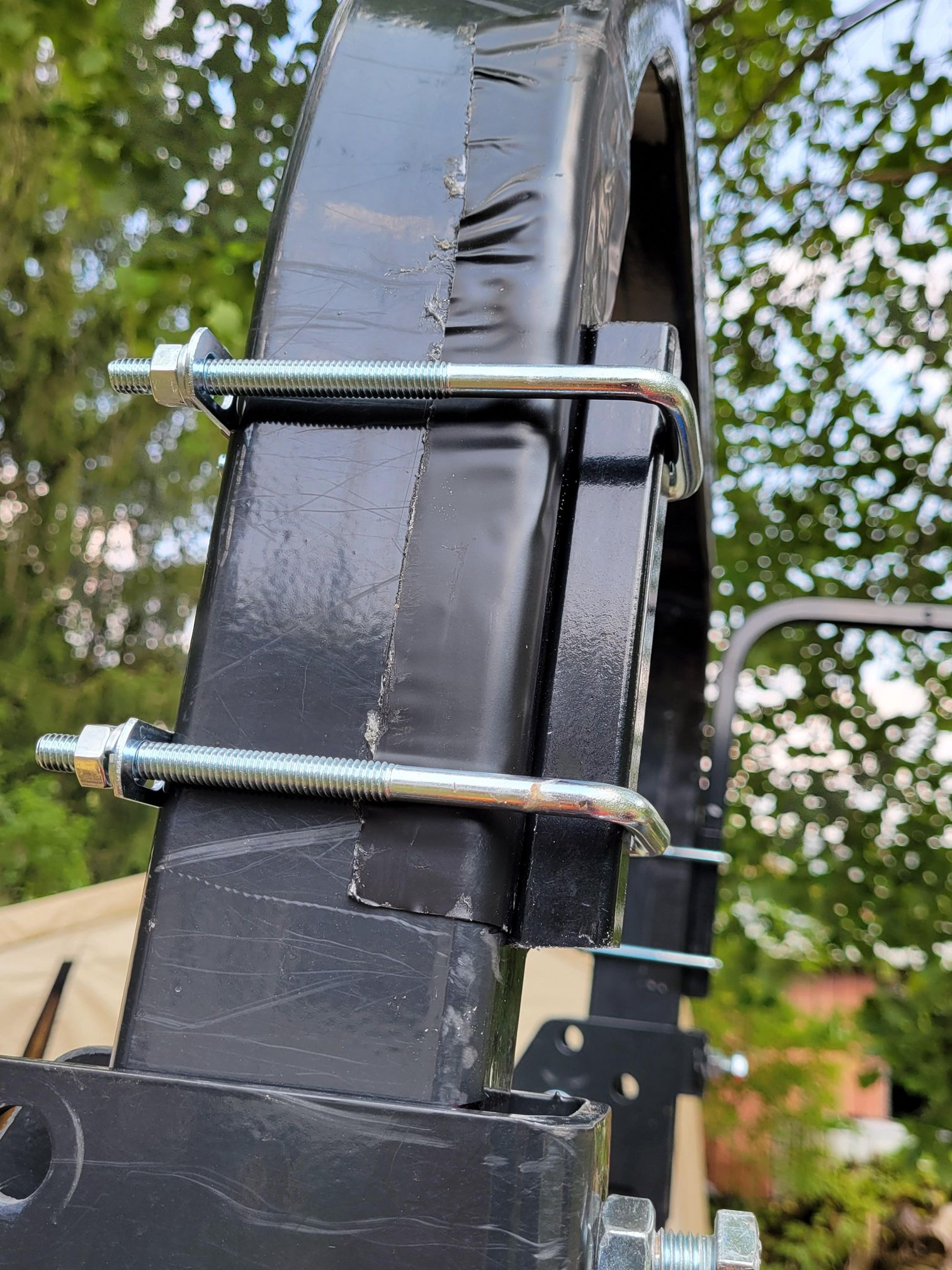

Cut a couple of 6" pieces from the middle cross bar:
Slip in side uprights now turned into braces:
Add canopy:
And viola! Removable canopy:
Don't mind the 'temporary look' of the place in the background. Still working on clearing out the place, cleaning it up, and getting ready for some garage/shop additions.

The 3 piece bar kit you refer to.... it's that factory stuff from the ezgo top?
/ Simple EZGO Canopy
It was aftermarket. The EZGO bars are, I believe, one piece and cost $$$. This one can be found on Amazon for under $90. I found it locally for even cheaper.

Ya, the tan's grown on me. My plan of using the flex tape for anti-vibration might not be such a good idea, at least higher up. Darn stuff is sooo gripy it's very hard to slide the rails out of the sockets.. LOL. Works perfectly to keep things in place lower down though.

Flex tape is basically rubber stretch tape with rubber cement adhesive (you can see the residue in the pics) already.

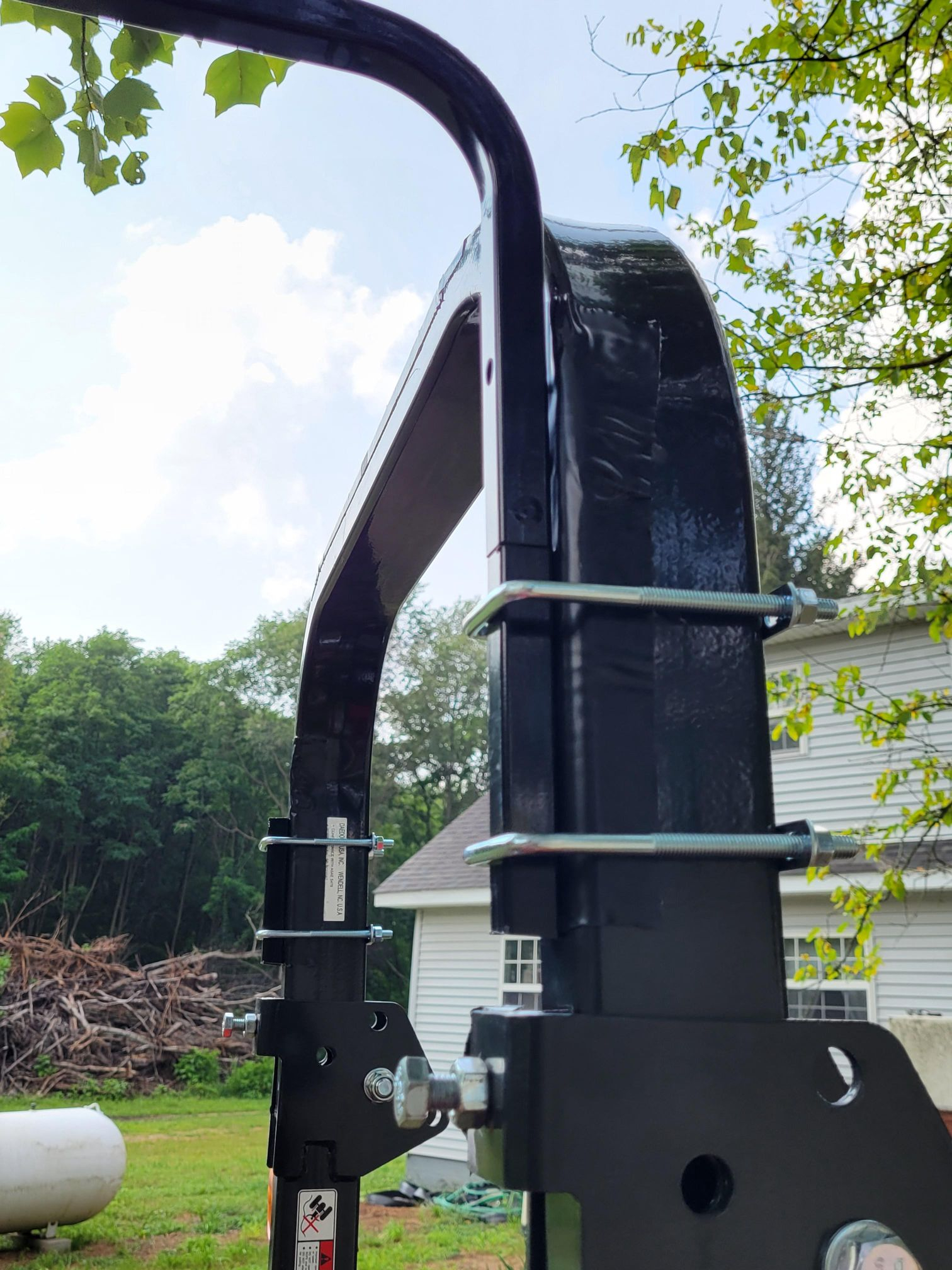

Painted up the u-bolts and end cuts (Ace no primer paint. Bubbled some). Pinned the bracket arms in place 'cause the roof wanted to rattle up and out some, and added some straps to the rear to also help. Whats not painted is stainless.
Tested it out for ~5hrs today and not once did the sun even hit my shoulders, much less my head. Works good and pretty steady and sturdy. There's recessed spots front and rear for bar light mounts too :)

The factory bar is not 3 piece, as far as I could find, so a lot more modification would be needed if you wanted it to slip in/out like mine. You could just cut the factory one in 2 and simply clamp them on with the u-bolts and loosen them when you wanted to remove the top, but its hard for one person to manhandle the top, u-bolts, and ratchet at the same time.
