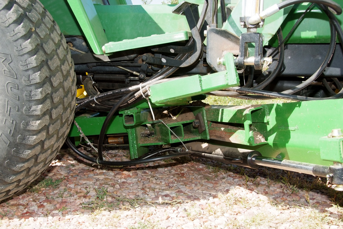

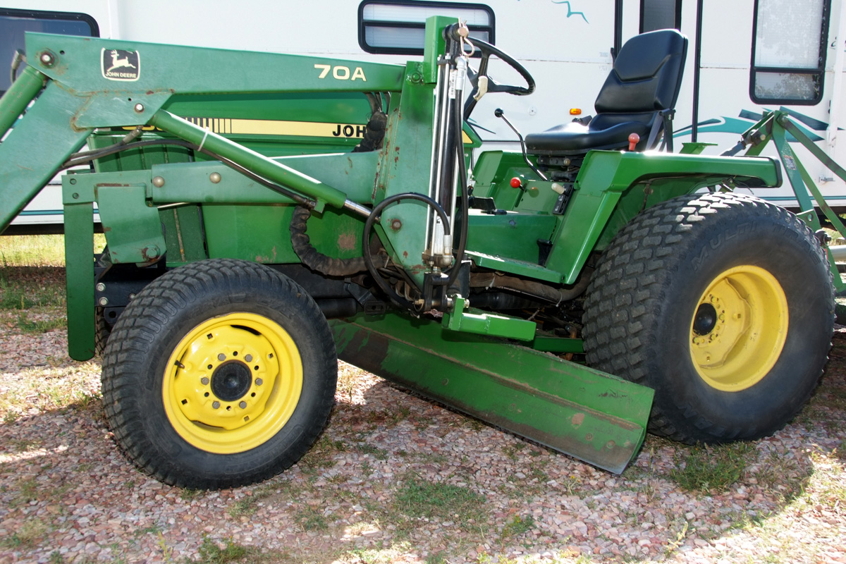

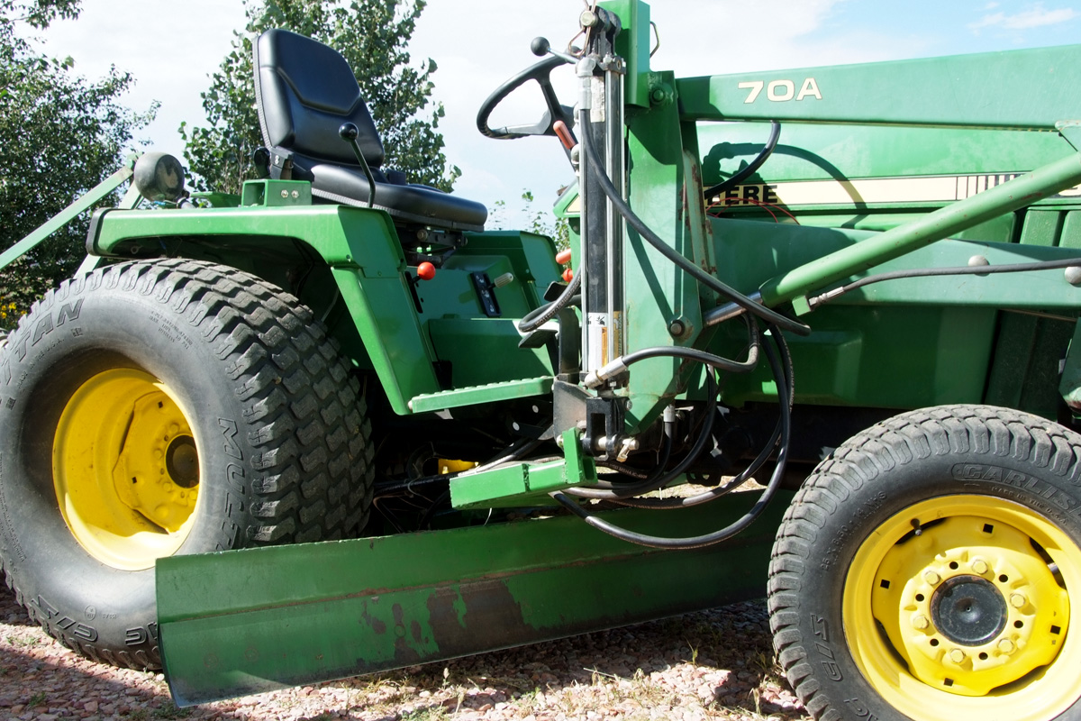

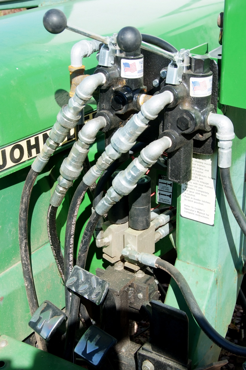

QUICK FOLLOWUP:
First, let me say thanks to everyone for all of the assistance on this project. The advice from J_J was particularly helpful, in fact I couldn't have done it without him. Anyway, the project is finally finished and works just as it should. I ended up using the tractor hydraulic system by installing the auxiliary hydraulic unit supplied by John Deere. I used the divider valve (suggested by JJ) to supply two electric open center valves which control the lift cylinders. The T output from one of these valves then supplied two manual valves which control the angle and sides shift cylinders. I will try to attach pictures, but I'm not sure I know how. Thanks again. Larry
   / Simple hydraulic question (I think) #26
I just saw your pictures. Looks good.
Let me recommend that you replace those water pipe fittings with hyd steel fittings as soon as possible.
Those fittings were never intended to be used as hyd fittings.
#27
Hi JJ:
I will do whatever you tell me to do. Why is it that these fittings won't work for hydraulics?

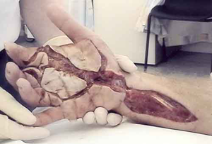

   / Simple hydraulic question (I think) #28
   / Simple hydraulic question (I think) #29
That is just pretty darn scary.
