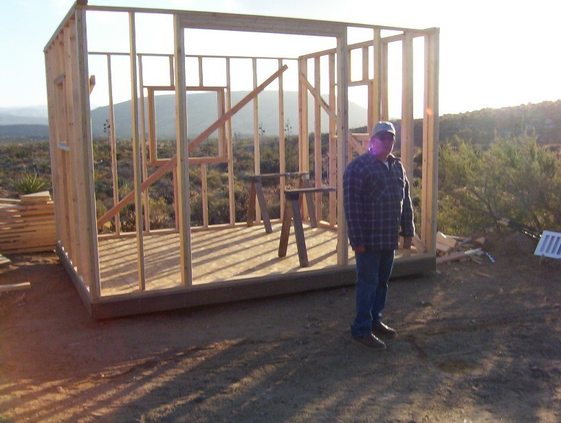

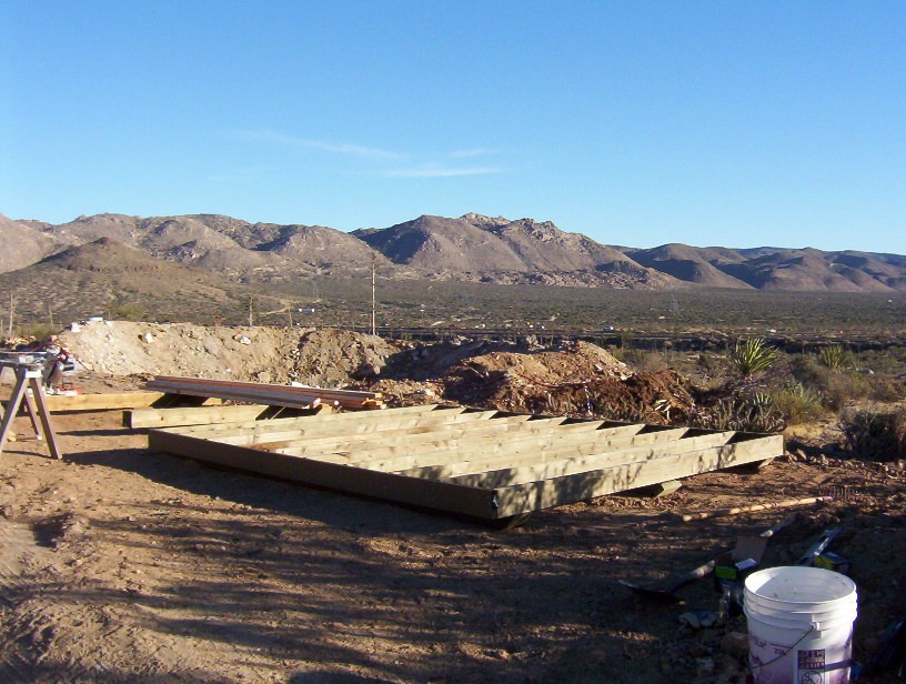

Sheeting would have helped I am sure, there are some other variables but 4x6 skids on a building that small are too heavy, everything will move before the skids will since they are the heaviest part of your structure. (I hope that makes sense)
I am not going attempt to drag mine but if I decide to move it I will pour a slab then jack it up and put round metal poles under it and roll it onto the slab. Here is a photo of my dad after our first day of framing and a photo of my skid foundation with pressure treated 2x6 floor joists spaced 16 inch on center. I used 3/4 inch tongue and groove sheeting for the floor. OSB which I will not use again for flooring.
