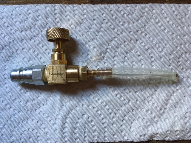

Was having trouble with 2 of the female connectors on my loader so I made up a couple of these. Connect them to the loader when I take it off, crack the needle valve to relieve the pressure and they connect easily to the tractor.

I like it. So far, i've been able to fiddle around to get them to work but when they finally let me down, i'm gonna wish i had one of these!

I can see the valve trick working, but unless you had everything on hand, it would cost a whole lot more than a small hammer and dowel.

Used a hammer and dowel for about 3 years and ended up having to replace 2 of the connectors because. I damaged the orings. That's why I was looking for an alternative. Got the 2 valves for $16 and the male connectors for $8 ea. On Amazon.
