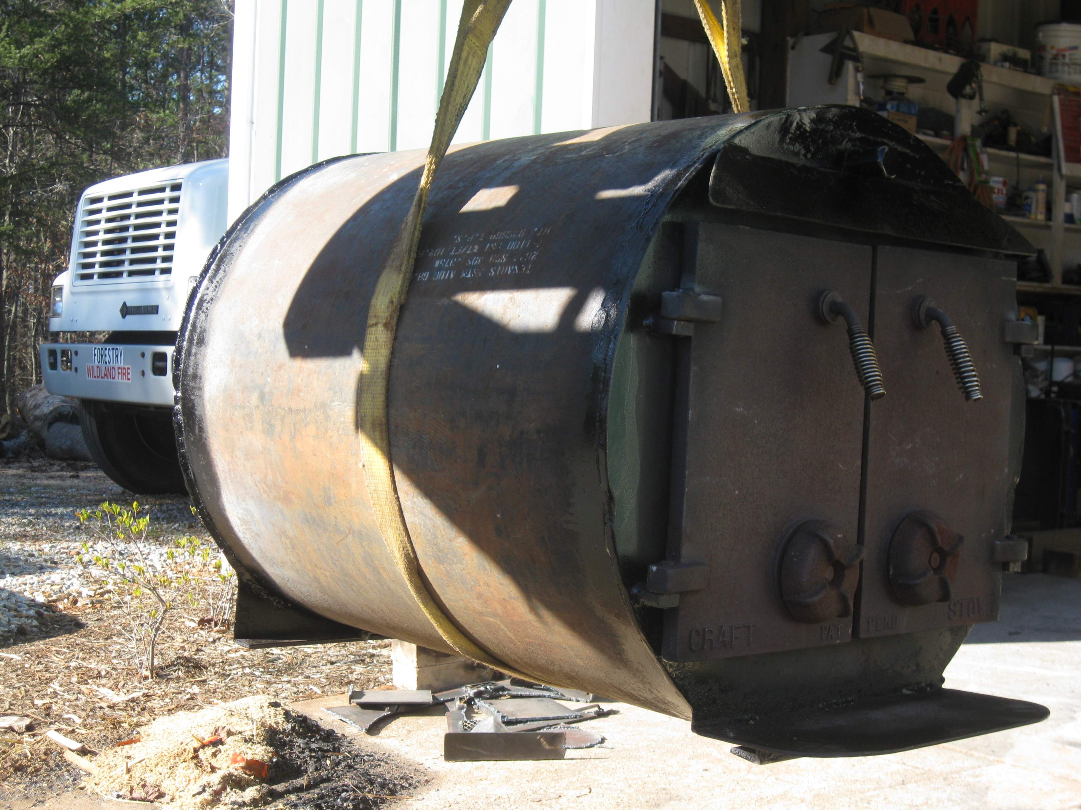

I wanted to build a larger woodstove for my shop and keep it as simple as possible.

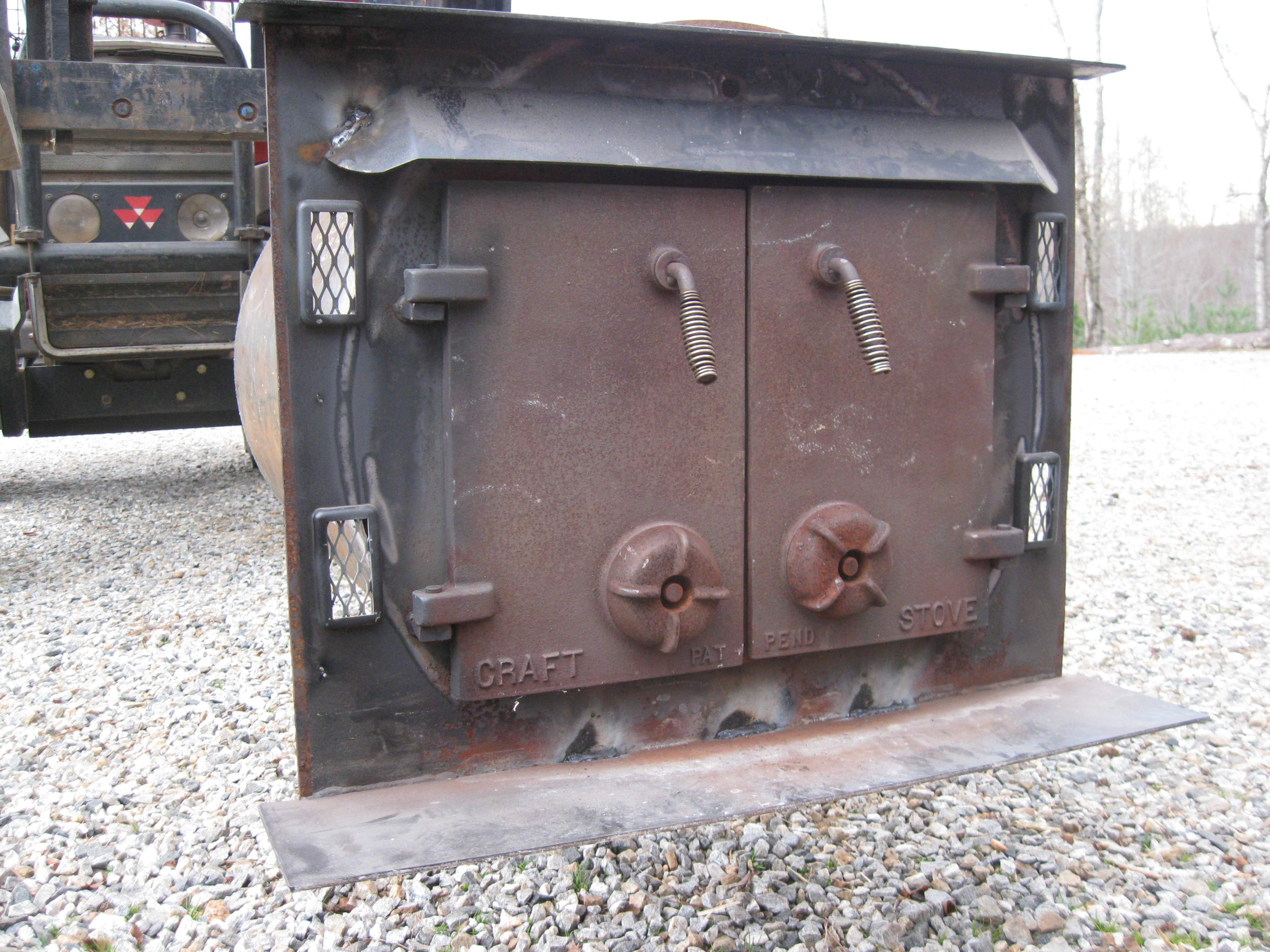

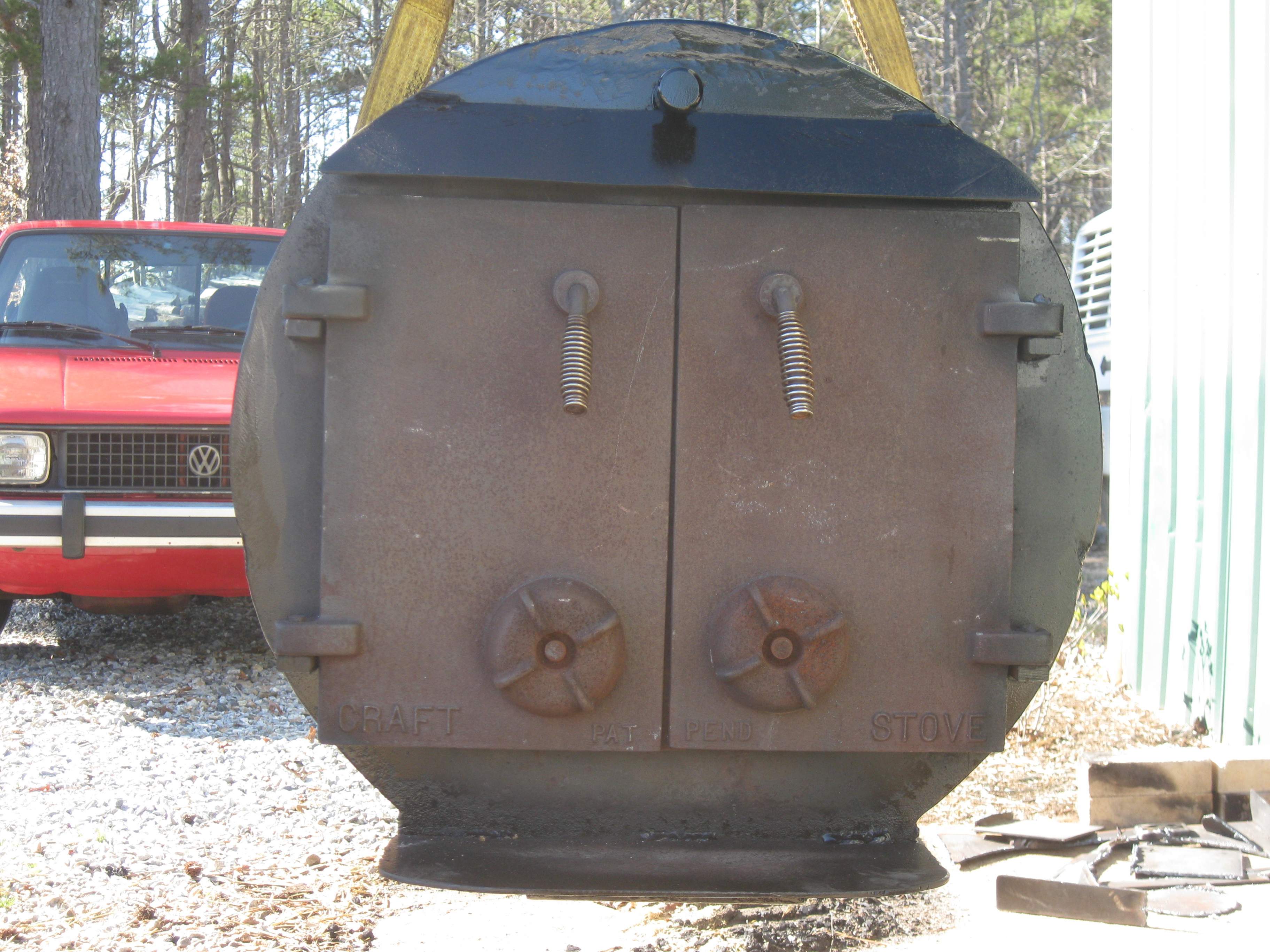

I started with an insert that was in my basement fireplace and was very inadequate and inefficient. I cut the entire face plate off of the insert and, after cleaning it up, I welded it to a piece of 26"x1/2" pipe that I made 32" long. Doing it this way I didn't have to make any custom doors.

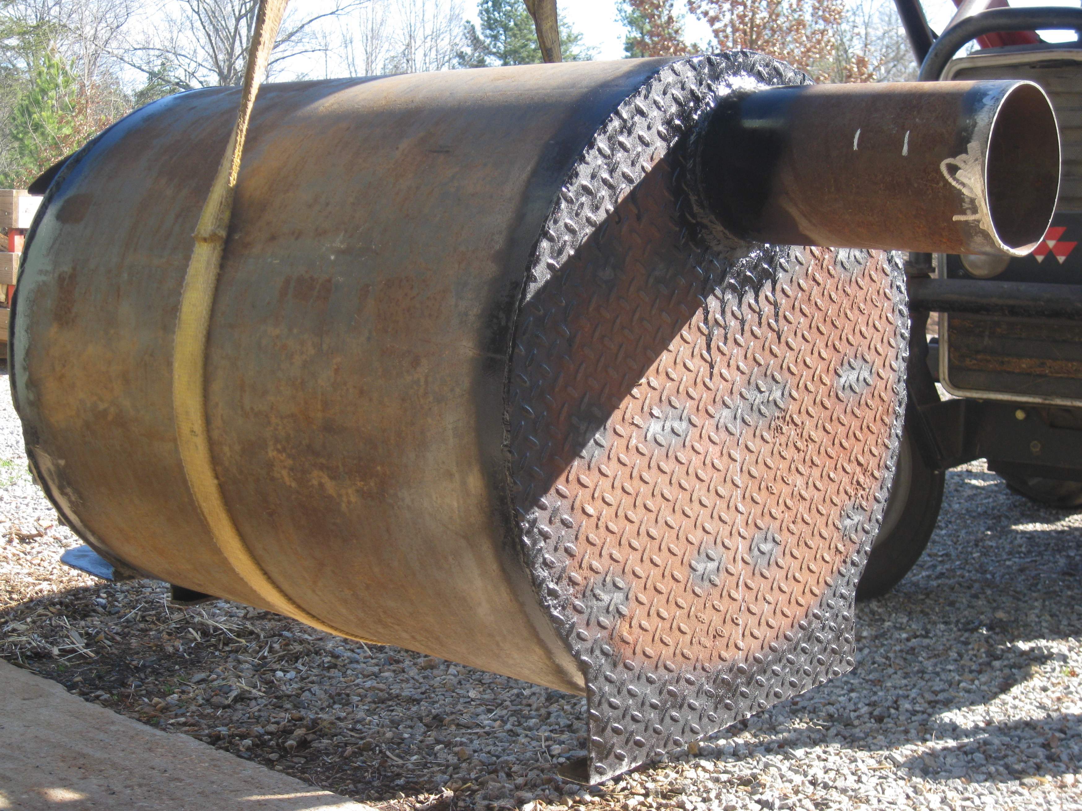

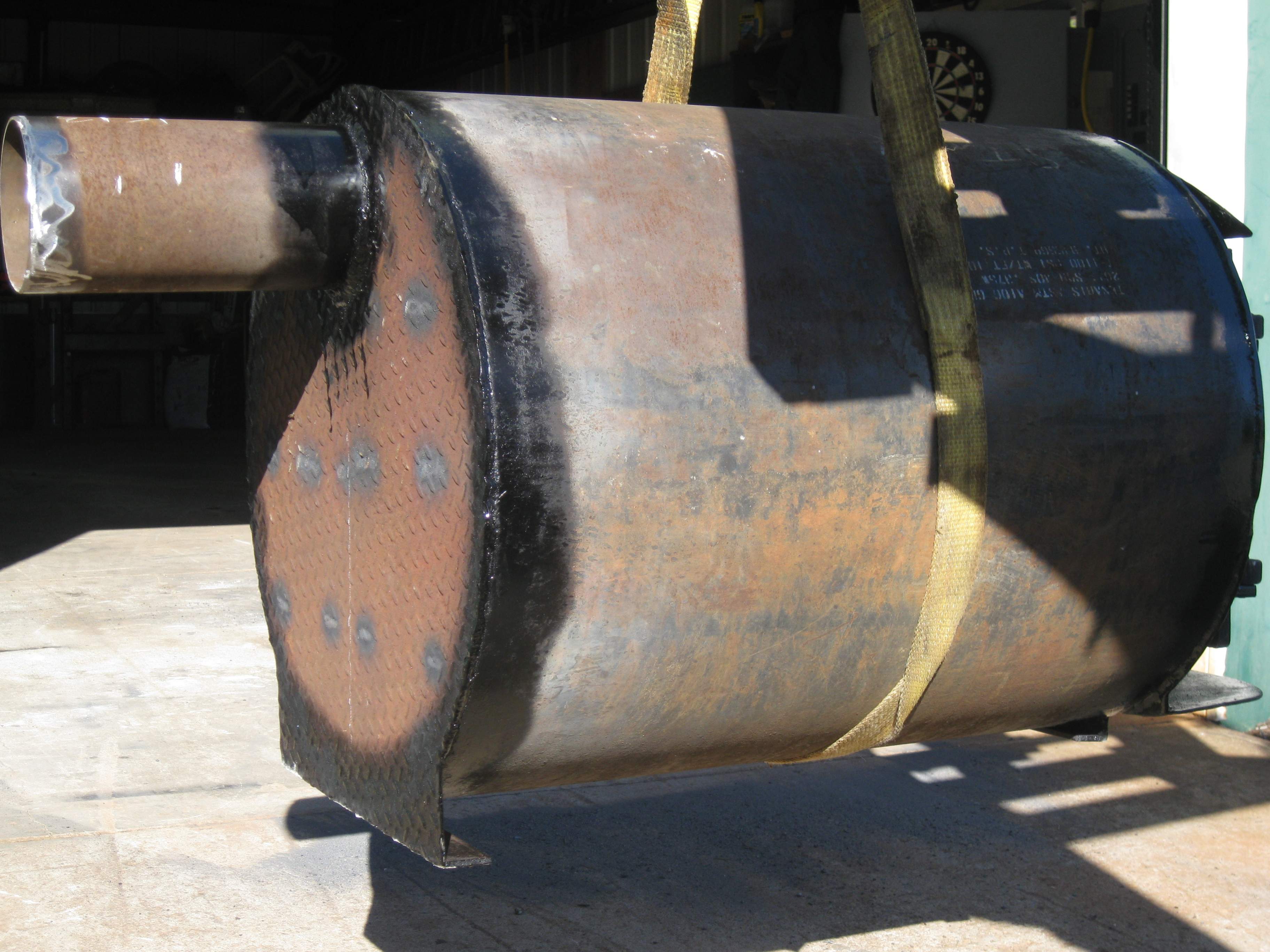

After that, I just closed in the other end of the pipe with an old piece of checker plate that I had laying around and added an exhaust. I also put reinforcements on the inside of the back wall of the stove to prevent warping.

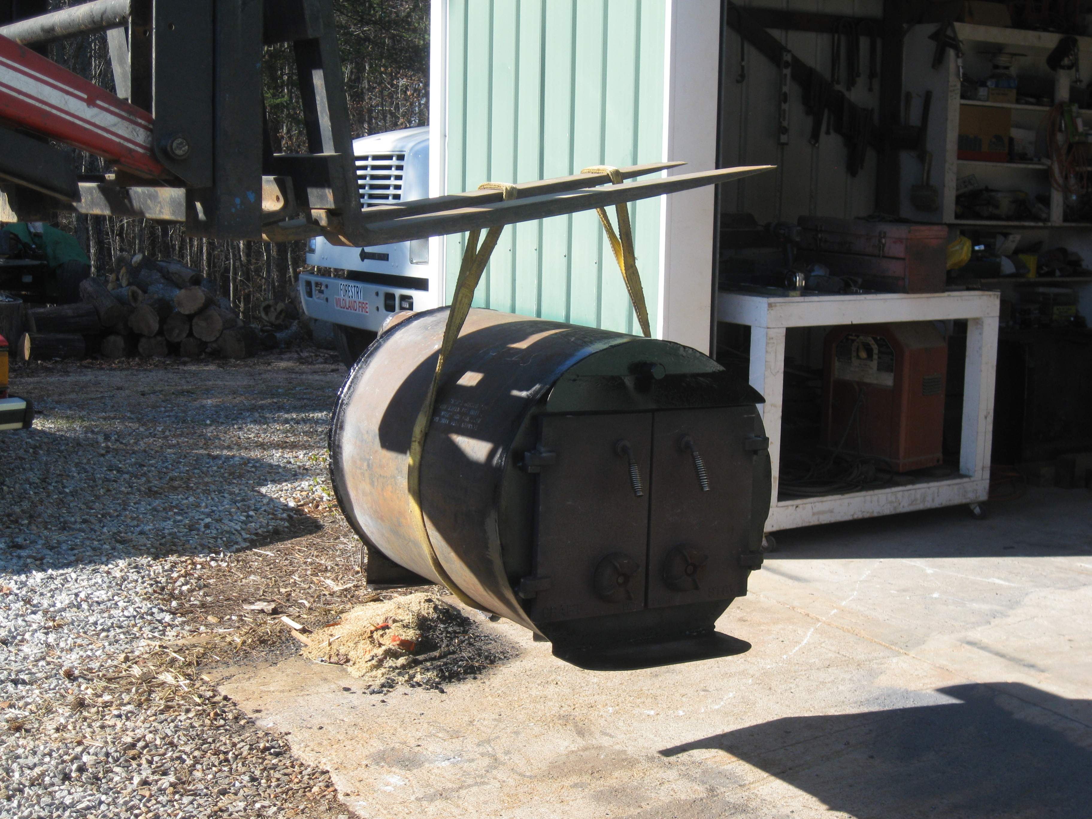

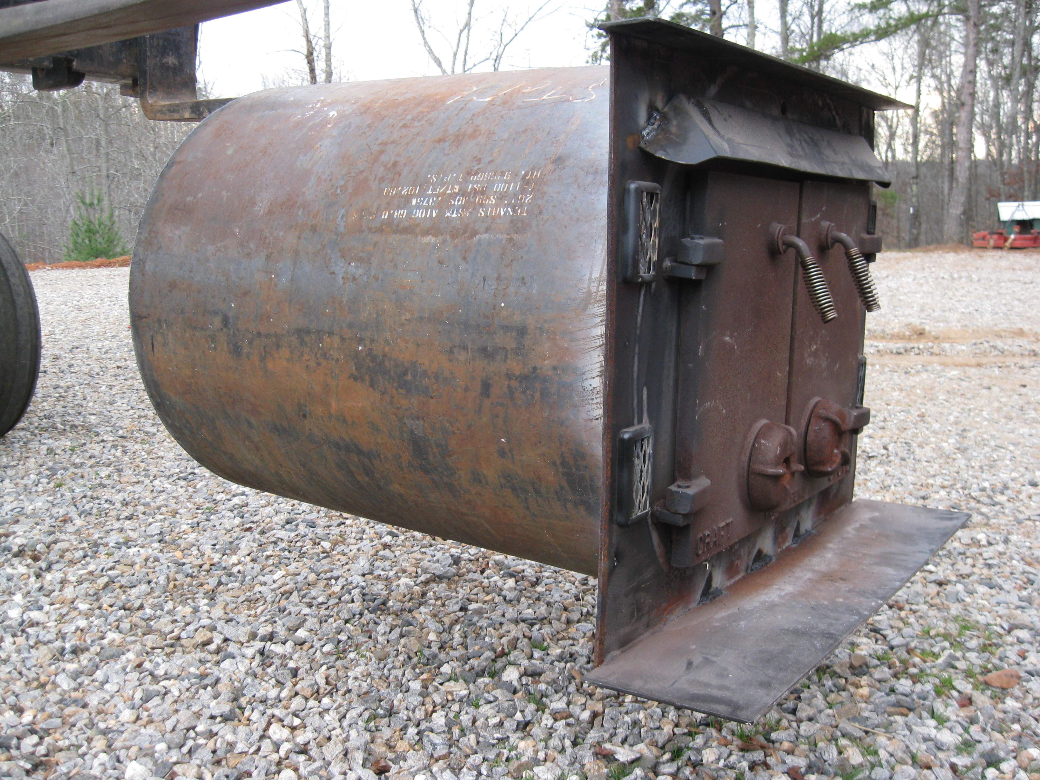

Then I went back and trimmed the excess from the front face plate to make it round like the rest of the stove. I started to leave it square, but I figured the extra would just get in my way in the shop.
I already had all the materials except for the exhaust pipe, which I gave $10 for. I roughly figured my total cost of this build to be around $75. That covers the torch gas, welding rods, grinder discs, and that exhaust pipe that I had to purchase.
The pipe itself weighs 103 pounds per foot, so I estimate the weight of the entire stove to be around 400 pounds.
I just lit the first fire in it and it seems to be working excellent.

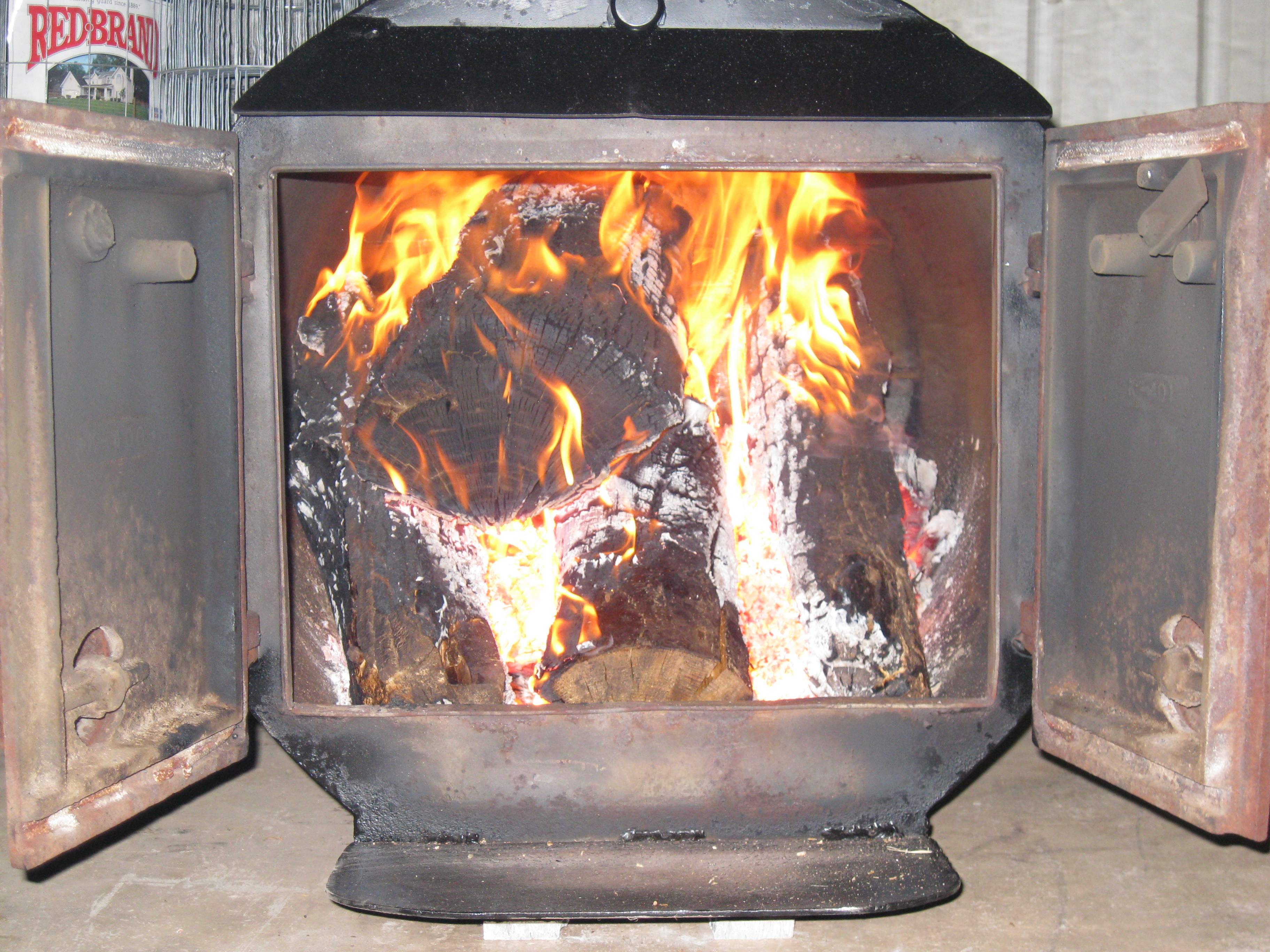

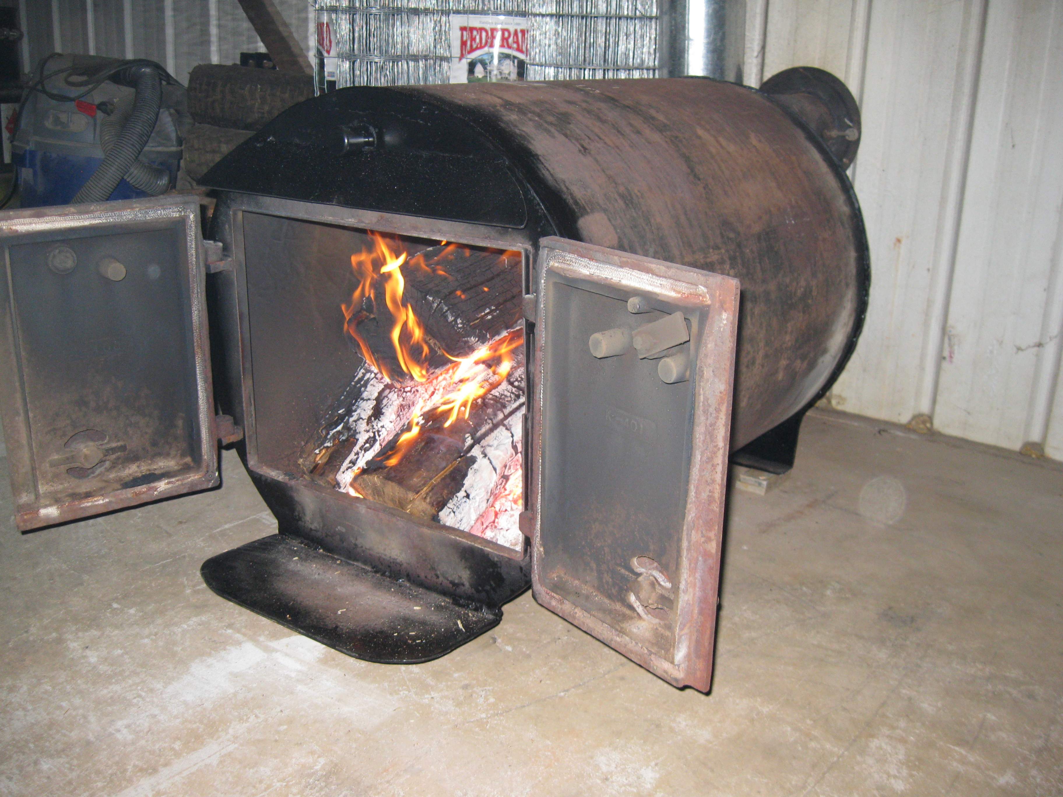

Here's a few more pics. I love the large size because I can throw whole logs in without having to split them (once a good fire and bed of coals is established). The round design seems to be working very well also. It feels like it is putting out an extreme amount of heat. It seems to be drawing excellent also.
   / Simple WOOD STOVE Build #3
Nice job.
How much distance between it and concrete floor ?, looks close, no worries about getting to hot and cracking ?
   / Simple WOOD STOVE Build #4
There is only 1" between the extreme bottom of the stove and the floor. I could put my hands on the floor a while ago and it wasn't too hot. It seems like the round design is forcing the heat to rise up and since there isn't a flat bottom to trap the heat it's not too hot. I've only had a fire going since about 3:30 though. I'm sure it will get warmer, but I poured the floor 6" thick so I think it should be OK.

Good job DIRT.
Aluminum foil or bright sheet metal under it will alleviate any floor heat problems you may encounter.
   / Simple WOOD STOVE Build #8
Nice job.
Doesn't heat rise ??
The floor around my stove in the garage (shop) doesn't get hot even when fire wide open and roaring to heat metal so I wouldn't worry:)

That looks like it will get very hot, nice job
Is the stove pipe outside and are you worried that it may not draw in extreme cold conditions.
