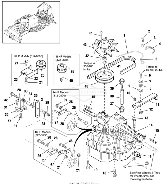

   / Simplicity Regent Torsion bar - need front hanger info #4
Pick a part, any part...

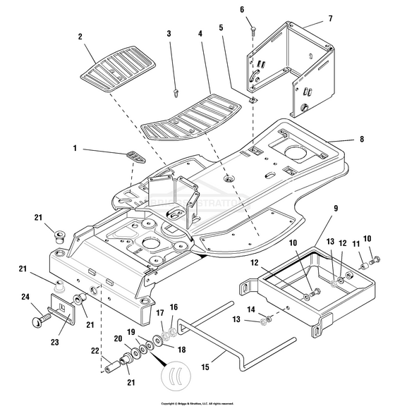

That is showing only the mower deck carrier. I went through the parts diagrams and no torsion bar carrier, only the mounts for the back.
   / Simplicity Regent Torsion bar - need front hanger info #6
I don't see many Simplicity riders. Isn't the carrier in that above diagram what surrounds the transaxle?
Here is a drive related image:

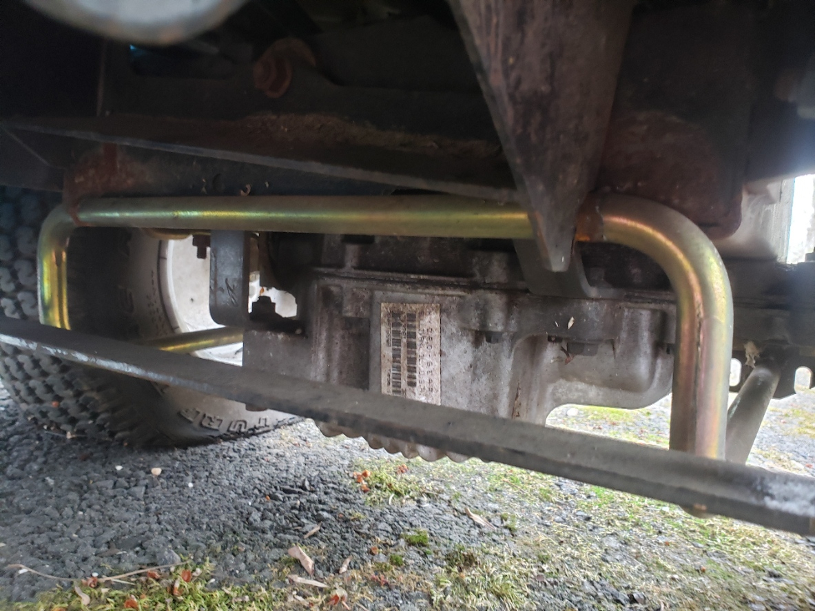

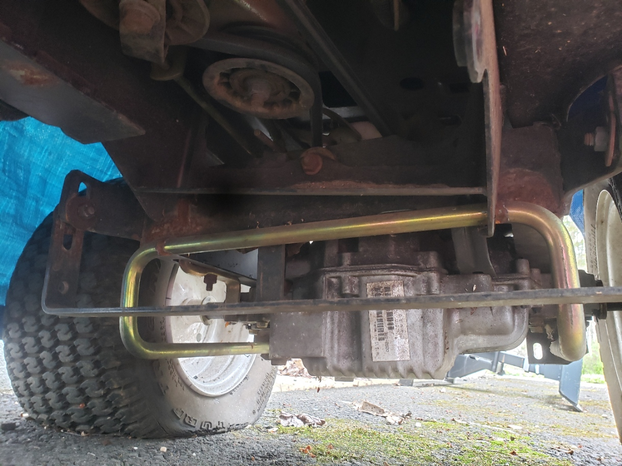

Simplicity is behind tractor and it's been raining here, pictures as soon I can.
The parts there are the back mounts for the torsion bar. Where the ends go.
The part I am looking for carries the bar in front, Like a hangar.
#9
Sadly, it looks like part of the frame side rails. I guess weld would be the only way to fix.
This is my spare parts machine, the one I use to mow is better, but not by a while lot.
Was hoping to give this to the kid for a runabout as we did the head gasket and valves and got it running real nice...
   / Simplicity Regent Torsion bar - need front hanger info #10
I would think that you could also bolt on a support, not knowing if you weld or not. the first thing comes to mind are the deck supports for the small Toro ZTRs.
