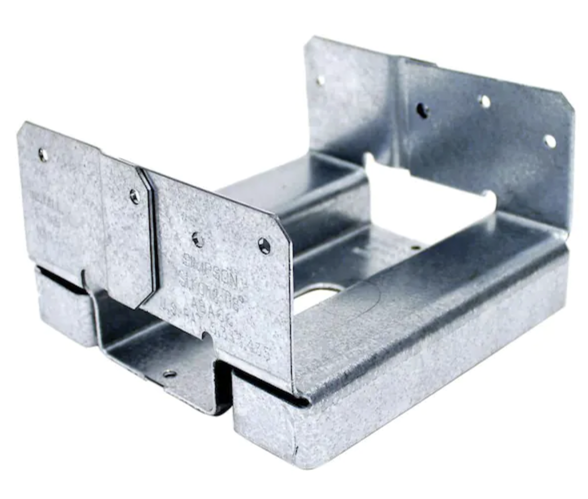

For my sawmill install I am going to use 6x6 posts for the wooden base I want to build. To me the best option to attach these posts to to the concrete base is using the $24 simpson strong tie bases at $24 (b4 tax) for this purpose. I am a bit of a cheapskate and I am having a hard time swallowing a $200+ outlay JUST for the post bases.
What are some other options? I am planning on pouring movable concrete bases 29"x28"x2.5" so burying posts is not an option. The posts will only be about 12" tall. I have scrap metal and decent fabrication skills but if the DIY option is going to take me 10 hours to make 8 I guess I am better off buying them. You guys have any post attachment tricks to help a cheapskate out?
/ SImpson Strong Tie Post Base DIY Alternative #2
Are you milling the 6x6 or using PT which is 5 1/2"? Also suggest you run a 6x6 PT flat on the concrete then build up from there. You could use these brackets too Post to Beam Bracket by Simpson Strong-Tie.
At the end of the day the PT 6x6 built up like "cribbing" would be the least expensive option and lag into the concrete with some inexpensive L brackets you can fabricate,

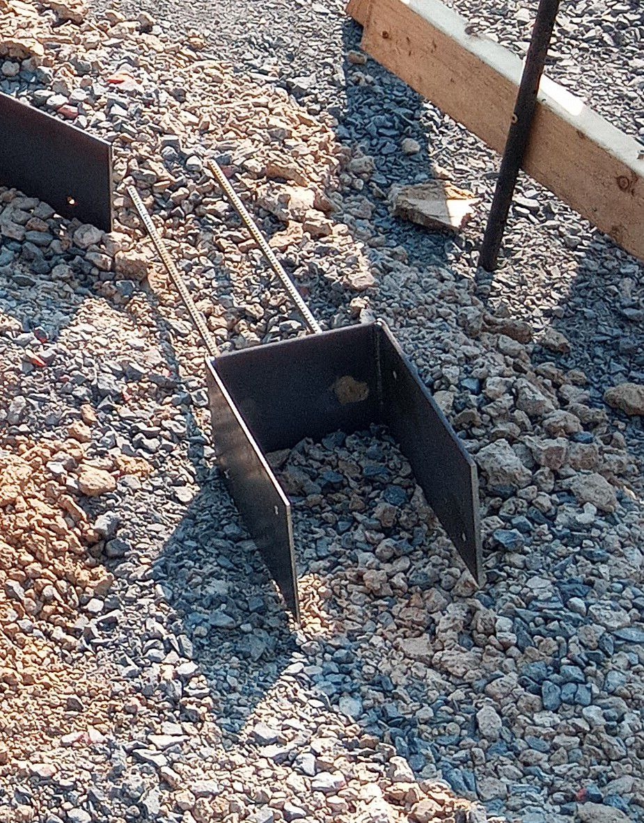

You could build brackets similar to this.
Also, FWIW, 2 inch thick concrete pads are almost guaranteed to crack. Better off building pads out of wood if they need to be mobile.

Yeah those dont look too bad. I feel pretty good about the 2.5" concrete not cracking, I will put some wire in it.
@Carl_NH I will probably buy PT. I want it to last and I am not sure about buyilding this thing out of green lumber.
/ SImpson Strong Tie Post Base DIY Alternative #5
In SE TN you should be able to get Black Locust without too much trouble. That would outlast PT lumber by a wide margin and be far stronger while it's at it.
