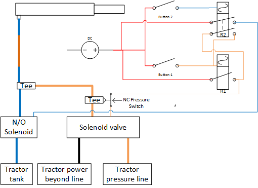

   / Single acting cylinder (w/spring) extend and hold position under load #13
Here is a drawing of the hydrualic and electrical connections as I see them. Orange is to extend the cylinder and Blue is to allow it to retract. The thick lines are hoses and the thin lines are wires
R1 is a SPST relay that is turned on by Button 1 and it will be held on by R2 as long as R2 is engaged. R1 turns on the solenoid valve to extend the cylinder (as long as Button 2 is being held down). The solenoid will extend the cylinder until the N/C pressure switch opens. At that point, the solenoid will return to neutral and the cylinder will remain extended as long as Button 2 is held down.
R2 is a DPST relay which when engaged keeps R1 engaged and closes the N/O solenoid that vents to the tank
When Button 2 is released, R2 opens. This will open R1 and the N/O solenoid which will vent the base of the cylinder to the tank and allow it to retract.
If you push Button 1 without pushing Button 2, the cylinder should stay retracted as the fluid should go directly into the tank.
Aaron Z

Aaron, thanks for the diagram. I really appreciate the time it took to design and draw the system. I am going to print it out and dissect it to understand how it works (along with your description of course). Right off the bat though, I do have a question. In this system would I have to press Button 1 each time after I let off Button 2 in order to use Button 2 again?
