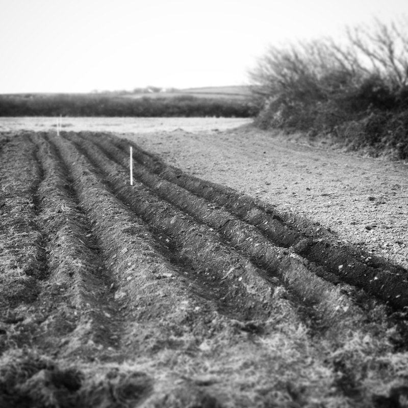

I have planted all my potatoes now. Still have a tray and a half left if I can find the time to start a new bed for them.
The ridger worked well in the end, and I did follow my original plan roughly. I made 3 furrows, one to plant in, the other two to walk in. Covered the potatoes with a log handle hoe, then put my wheels roughly over the covered potatoes and drove between to hill them up. Moving along a row at a time to keep track of where the lines of potatoes were. Covering potatoes on the way up, creating a new trench on the way back.
I have no idea how accurate I've been yet, and did have to re-cover a few by hand as some rows weren't as straight as they could be due to the rider hitting a fold of turf or similar. I should be able to correct with the hoe if they start growing out the side of the ridges!
After adding 65kg of wheel weights, the job wasn't too taxing. Worst bit was placing the potatoes by hand!
Here's a couple of pictures during and finished if anyone's interested.

Looks good, And I use the same kind of electric fence posts for markers too.

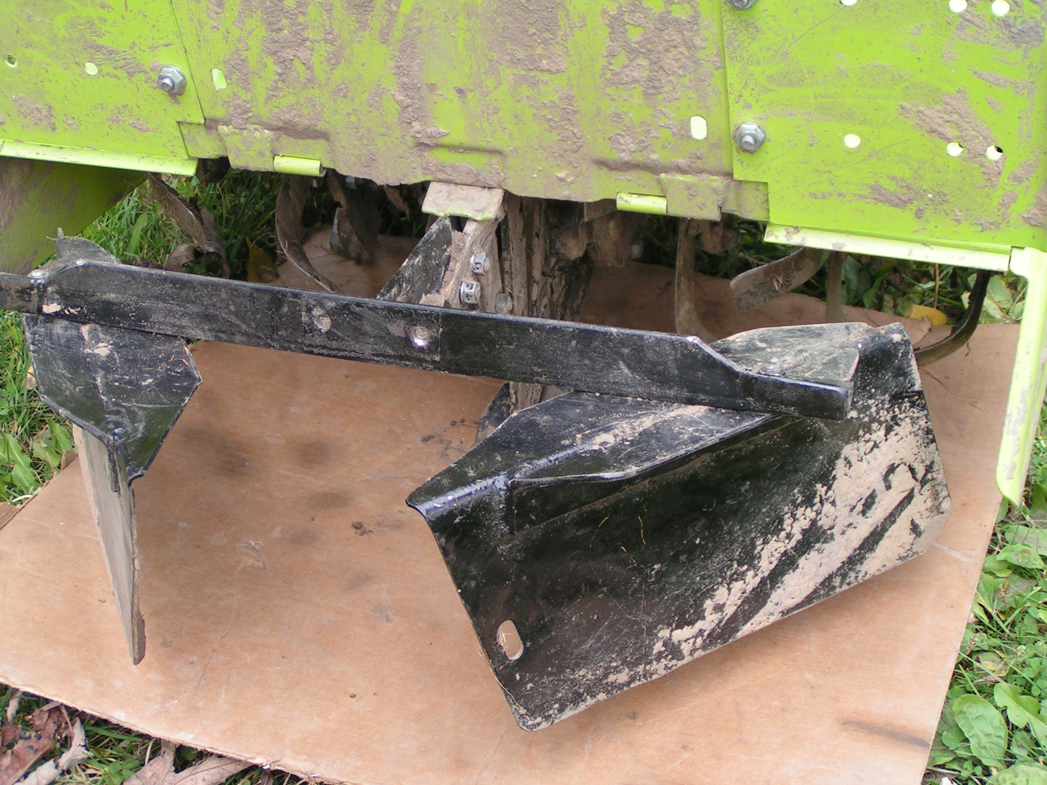

Hi! Some years ago! I make and use this implement. Tills and makes small hills in same time. Now I use rotary plow for make beds 3 FT large for two rows on the top. Good Luck! OldmechPICT0066b.jpgPICT0073.JPG
