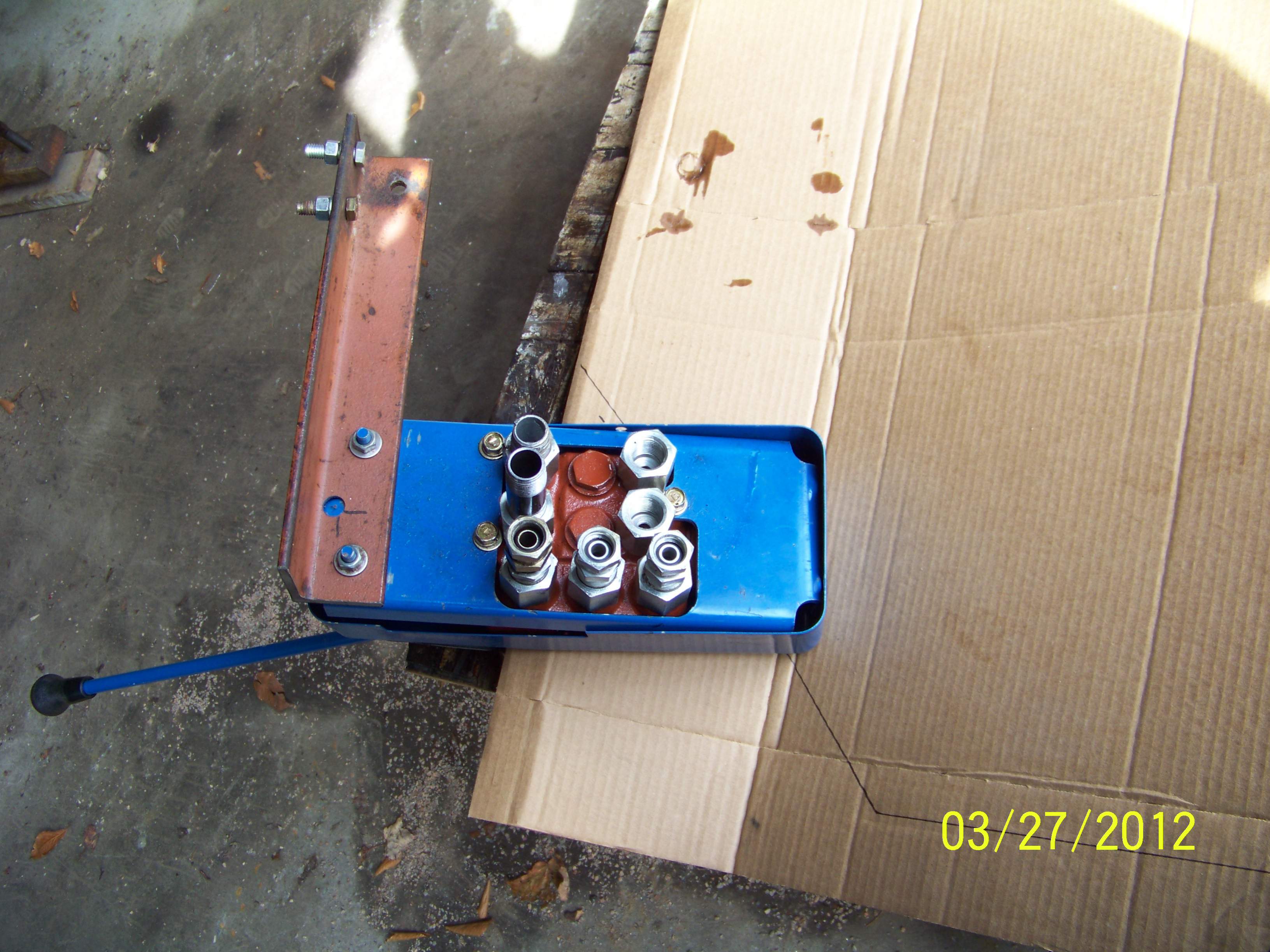

Trying to install a single lever loader control in place of the 2 lever on my 2110 Ford. It is a NOS for a 2120 Ford around 1988. It is a Zexel stamped 46224 on the ID tag, which states Assn. No 307800-0721, Assn. Code 34001-3541. I don't know if it needs or I should say they use a power beyond bushing in the power beyond connection, which I believe is the one farthest away from the operators position. The center connection I think is the inlet, with the return being closest to the operator. Any info will appreciated.

Running on part numbers takes specific knowledge. You could gain the universal knowledge of this very knowledgeable group with just a photo. (or two.
Sometimes, the external appearance of a valve gives a clue as to what is going on inside.
Take out any port plugs and have a look. PB bushings have "features" that may help in identification.

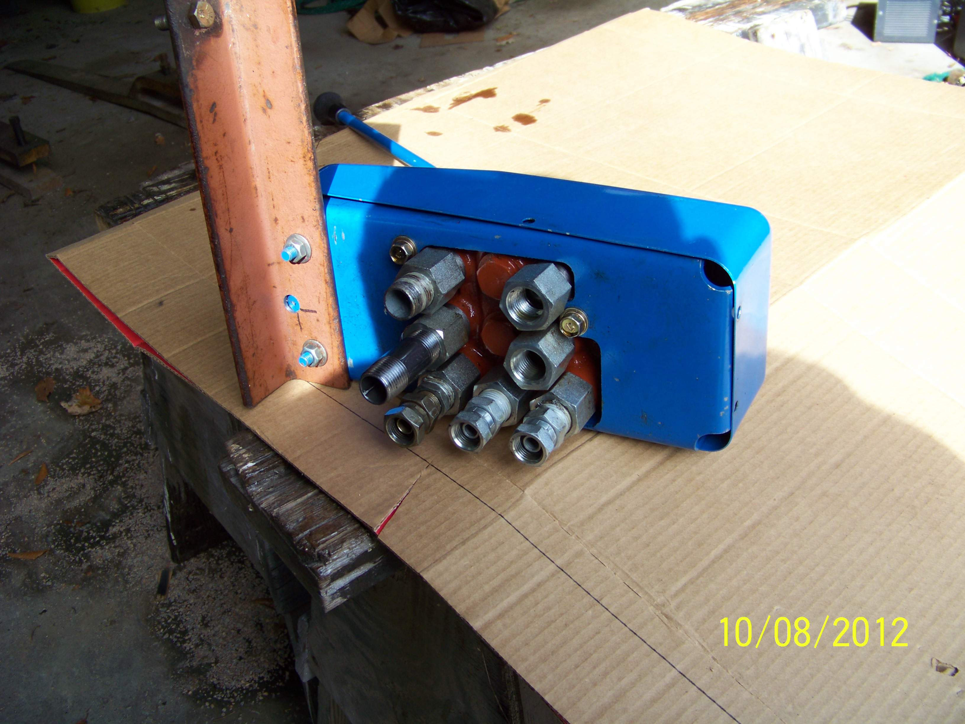

Back from Fryeburg Fair and have caught up on chores. When I hooked up the controller like I thought it should be connected the Up,Down and Float function worked properly, but when I dumped the bucket it went all the way, then could never get it back or to curl. I took some pictures included are the pictures. 101_0964.jpg 101_0964.jpg101_0964.jpg I hope this worked, there should be three pictures.
   / Single lever loader control
It didn't work. Another picture.101_0962.jpg I'll try one at a time. One more try.101_0961.jpg

Would this be it? Ford/NH 1220
Expand the Hydraulic Systems folder and about half-way down is a couple of references to 2-Spool Remote...
And here is another thread that might have all the info you need... (click here)
