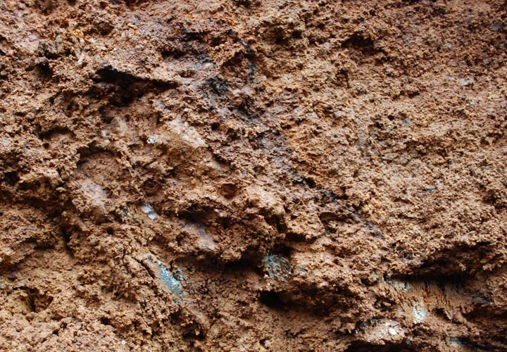

Ripping the vine row itself prior to planting improves drainage in the rooting zone, but that is not the primary purpose. The main reason this is needed is to break a dense clay layer that averages around 28" to increase the effective rooting depth. If it is not ripped, the roots will not easily penetrate past this layer. In a layer like this, ripping does more than just slice a cut in the layer. Wingtip ripping creates upward pressure on the layer and fractures the layer to the left and right of the rip itself - as long as it is done when the soil is not too moist.
The depth of the layer was identified by using an electronic soil compaction/penetrometer probe and a soil survey (first photo) with observation of mottling (second photo - horizontal accumulation of mineral deposits, indicating a drainage restricting layer, i.e. compaction).
Ripping at 24" would be above this layer and not accomplish the goal of improved effective rooting depth. Should anyone be interested in diving deep into this topic, here's a good USDA pdf.
