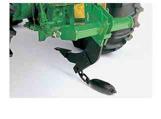

John Deere offers one with a mole ball that leaves a tunnel behind for a wire/pipe to follow easily in. But you may need a bigger tractor to pull it.
I broke up 40+ years of no till clay on my place with a Deere 10A with a mole ball and the 10" wide tip. Shortened the top link a bit and it lifted and crumbled a 2" swath of soil . Had to molboard plough and cultivate to smooth the field as front tires would drop to the axle in the trenches
Haven't had rain water pond on the field since.
A small tractor can make several progressive passes deeper and deeper.
   / Single tine ripper #25
The Deere sub soil ripper is good but is a hard pull. I got a good deal on one about 8 years ago but find that most of the ground in my locale would require a larger tractor than I have to pull it.
   / Single tine ripper #26
Look familiar except the tip on mine is 10" wide. It shatters loose a wide column of soil. The JD 1640 pulls it in clay with 3rd or 4th gear and the ripper as low as it will go.
