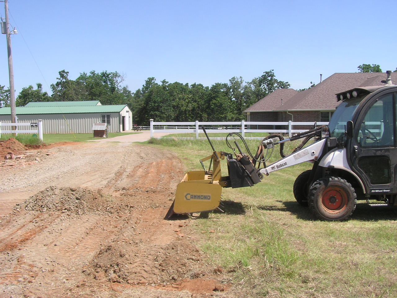

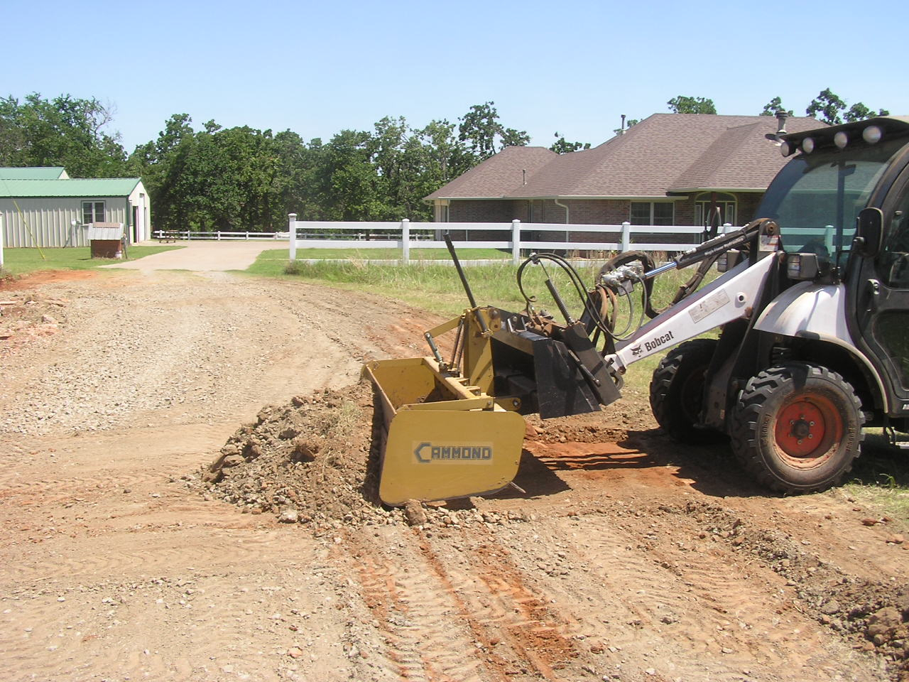

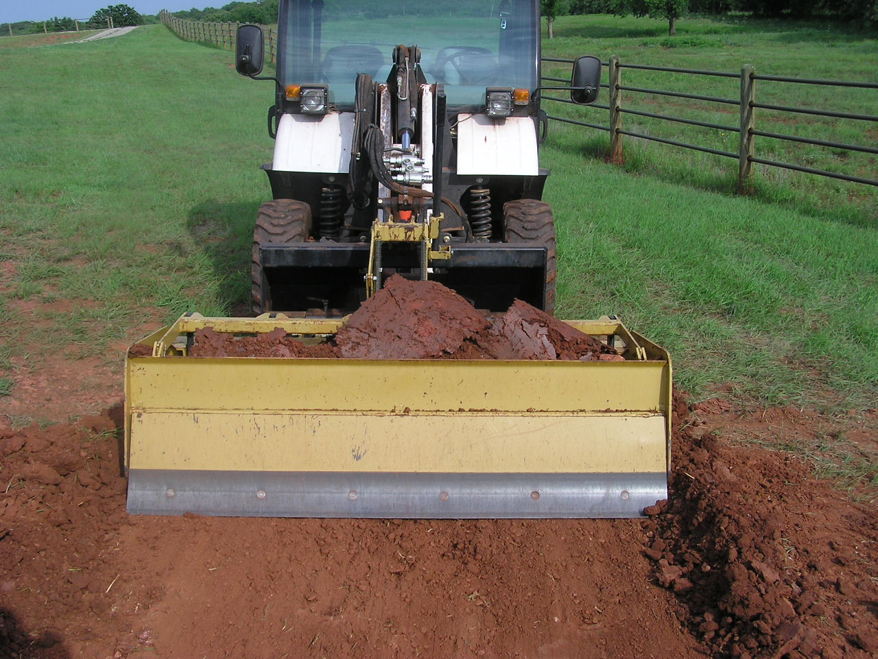

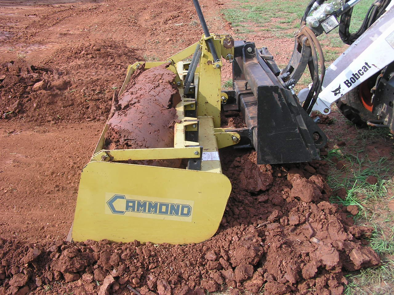

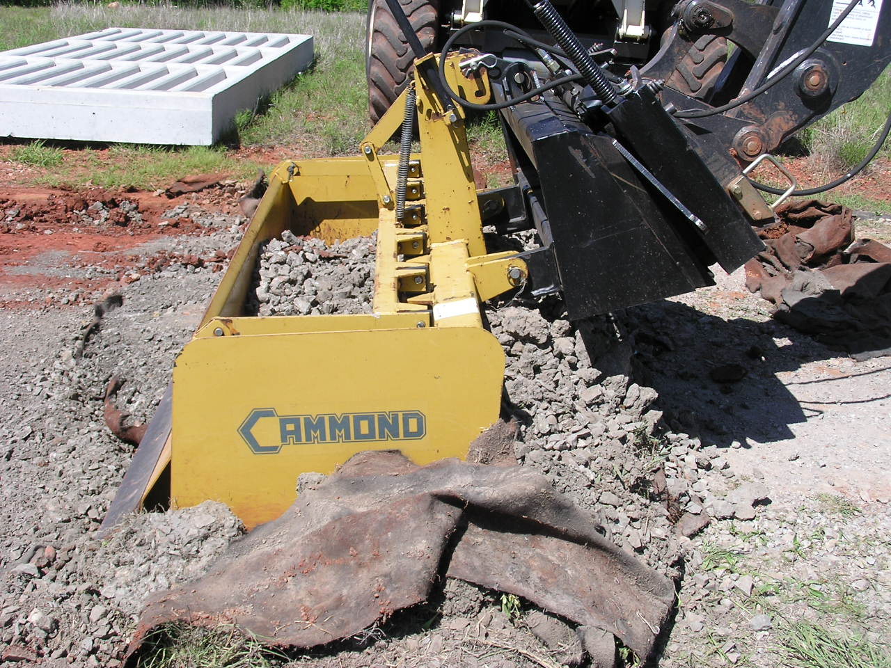

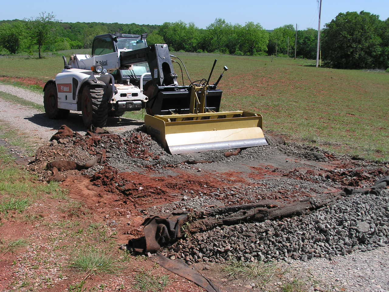

Not a flail mower, it is a 6' box blade that was pictured in post #18 of this thread, Piston was asking how the Versahandler would do for grading trails into a hillside, so I showed the Tilt-Tach tilted.
Here it is not tilted:
And on the V417:
I had an Oliver HG-68 with a front loader on it, neat little crawler, but not geared low enough for dirt work. It is possible to add a Ford Model A 3 speed transmission ahead of the transaxle, put both in reverse and you have a crawler gear for the crawler! :D

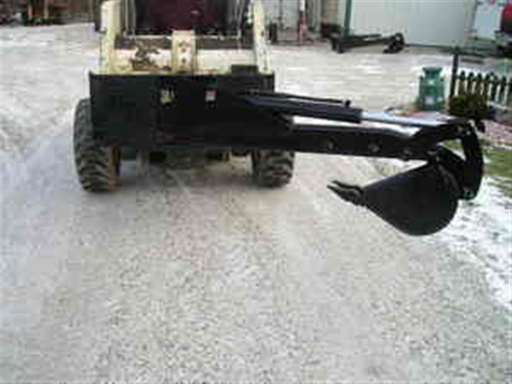

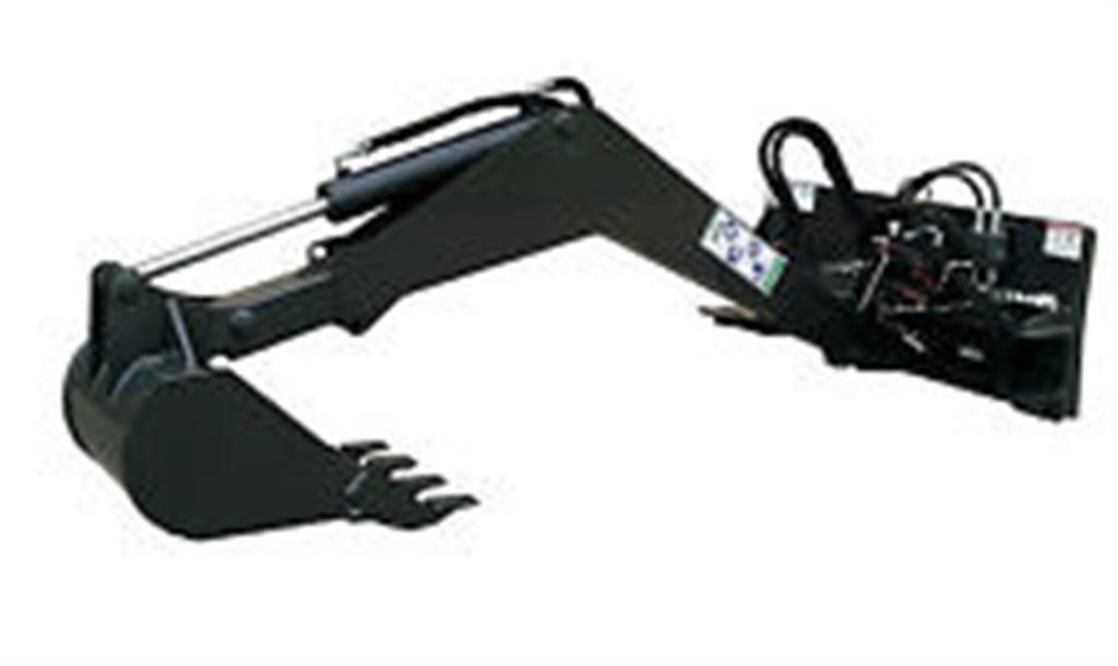

Keep in mind as you are trying to decide a decision, there are backhoe attachments that will work on the Versahandler, and can be removed in less than a minute. Turn the pressure release lever, pull up two levers, disconnect the hoses, drive away.
