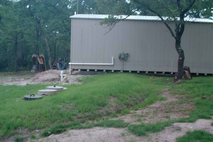

The aerobic system has a raw sewage aeration tank, an effluent filtration and chlorine treatment tank, and a clear water tank that holds 500 gal. The raw sewage tank has an air pump that bubbles and swirls fresh air up through the raw sewage to aid bacteria to decompose the waste just like a city's sewer dept. does. When the clear water tank gets nearly full, a float turns on a submersible pump and sprinklers pump the water out onto the ground through a 2-head sprinkler system just like the ones people use to water their lawns. There is no odor whatsoever and the chlorine ensures no bacteria escapes the system. Grass around the sprinkler heads is "happy grass.":)
Here's a picture of my system when it was being installed.
EDIT: I found a brochure picture too. The brochure doesn't show the fresh water tank because some places would require an absorption field rather than sprinklers.
