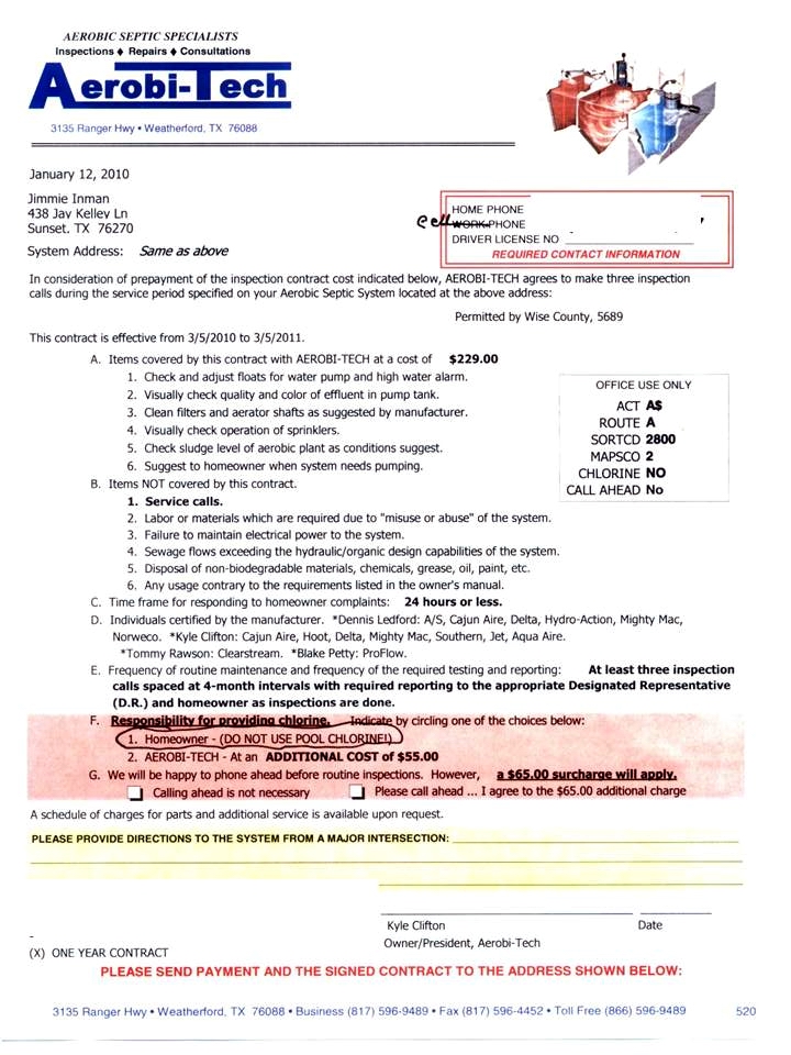

Mike, my service contract was included for the first two years after installation and then it was $200 per year for once every 4 months (3 times annually - see attachment). It recently has gone up to $229 per year and I have to supply my own chlorine pills. The chlorine can't be pool chlorine and I buy it from my service company. I use about 5 lb per year and buy a 10 lb bucket of pills for around $35. If they add chlorine, it's $55 extra per year. Some newer systems just use liquid bleach and that would be ideal in my opinion. As a matter of fact, I may try to find a bleach drip retrofit for my system some day so I don't have to mess with buying, storing, and handling the chlorine pills.
As a homeowner, you can attend training and service your own system, but you will also have to provide your county public works department with paperwork and inspection reports. You are granted a license to run a sewage treatment plant by the state and they expect you to meet their documentation requirements or be fined. The problem is that you may have to travel to a remote location and pay to attend their training class. The cost could be several years of paying for a service contract. I'd check with your county to see what they would approve.
That said, my neigbor doesn't have a contract for maintenance on the identical system as mine and he is NOT maintaining it correctly. IT STINKS! I'm pretty sure he has told the county that his system is shut down and they don't inspect to see that he is telling the truth. I hate to do it, but I'm gonna complain. There are three of my neighbors with faulty or no septic systems and it's time the county did something about it. I pay through the nose and maintain my system religiously under threat of fines. Why should these other folks get away with polluting the environment with their waste just because they are poor? Sorry about the rant. . . .:mad:

Mike, in 1997, I paid $5,000 for my Hydro-Action brand system, plus the permit and soil test although I understand they've gone up considerably since. And like, Jim, that installation included the first 2 years of service. After that I, too, was paying $200 a year and bought the chlorine tablets in a 25# bucket. I'm sure all those prices have gone up in the last 13 years.
   / Sir, are you a vegetarian? #16
A $65 surcharge for calling ahead? That seems a little steep for a courtesy that should be a part of their "service"
Obviously, they don't want to have to call 20 people a day per serviceman to tell them they are coming, especially if they can't make all the planned calls. If there is anything I need checked special, all I have to do is notify them before the normal service call and they will do it. When I had an aerator pump go out, they scheduled my service to coincide with bringing me the pump and saved me a $75 service call. I too think $65 is steep for calling ahead, so I'm sure that means they really, REALLY, don't want to do that for some reason. There is no reason I need to know ahead of time and there is nothing they can't get to as far as access to the system. I suspect they sometimes come up against a few dogs that aren't too happy with the guy messin' with stuff in the dog's territory. In my case, all we have is a pack of guard kitties.;):laughing:
