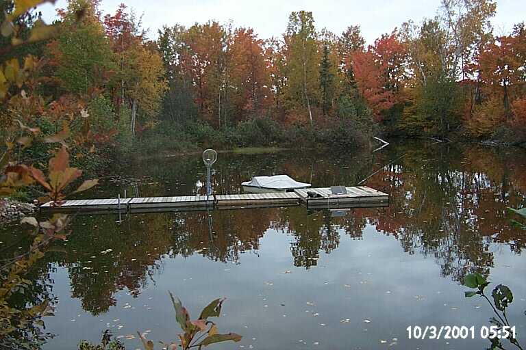

I love my floating dock! The pond level varies considerably between spring run-off and end of summer, so floatiing is ideal and I love to sit so close to the water. There are three 4'x 8' sections and one 8'x 8' at the end. It is built out of pressure treated lumber and pink insulation board (not the white "bead" type). I was going to use barrels, but barrels get pretty "tippy" and high off the water unless there is enough weight. Besides, I wasn't sure I could find enough barrels to do this.
It is "bouncy' enough to intimidate most people - you need your sea legs to walk on it. I ordered the hardware from Follansbee Dock. I just drop (not pound) in the poles to steady it, and I put solar lights and net in the poles. There is a bronze frog fountain and solar panel on the side and rod holders w/rods at the end
It will hold quite a few people, but is only comfortable for two or three adults with lawn chairs and/or fishing poles on the end section (especially since my Great Dane follows me everywhere). If I were going to redo it, I'd make the end section larger - maybe 8'x 12'.
Oh yeah - the pond is "P" shaped and about 75' x 150' on the main area and 8' deep pretty much throughout.
Pat (Techno-Tractor Mom)

   / (Sitting on the) Dock of the Pond :-) #17
Yikes, Pat!
Couldn't you find a more recent picture? /w3tcompact/icons/laugh.gif What with the geographic time warp, I was viewing your pond about an hour before you took it. /w3tcompact/icons/crazy.gif
Looks like paradise to me. Gorgeous colors. I might have to rethink my preconceptions of upper Michigan. /w3tcompact/icons/wink.gif
You guys are creating a new project for me. My fixed-post dock is now about 10 feet above the pond basin, which is nearly dry at the moment (long hot summer continues). It's a little unnerving 'cuz my kids are quite used to running out to the end whenever it suits them. Guess I should be fencing it off for that reason alone. /w3tcompact/icons/frown.gif
These floating docks make a lot of sense, but I'm thinking I'll need a pretty long ramp to handle the 8-foot drop (normally) each year. Any rules of thumb on that aspect?
