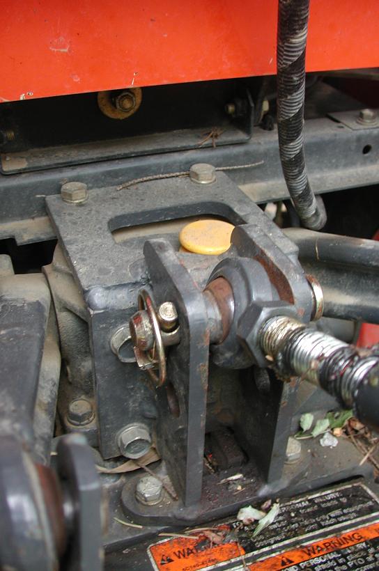

I have the 4690B hoe does this mean I already have the reinforced top link??
Also I can not get the part #'s off the link... can anyone help??
   / Size of box blade for B7800 #5
<font color="blue">I have the 4690B hoe does this mean I already have the reinforced top link?? </font>
The heavy duty top link bracket is a requirement for the backhoe. If you dealer did it right, you have it.
I don't have a part number...but if you look at the bracket, it is held on with six or 8 bolts...I could take a picture of mine and post it if it would help...
   / Size of box blade for B7800 #7
Here you go...I think the giveaway is the way the heavy duty top link wraps around the transmision oil fill hole...
