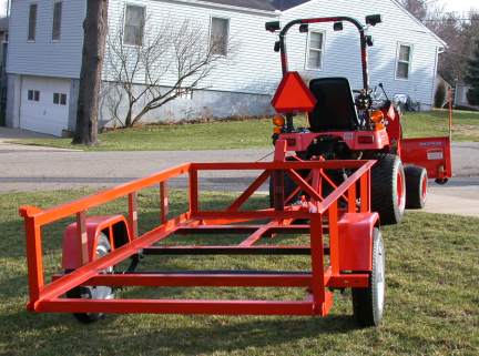

Redharley, I am in the middle of modifying a 4X8 trailer from TSC for the back of the BX, it will have a hyd cyl to tilt the bed. I have pulled a 6-1/2' X 12' trailer full of family and kids the last two Halloweens, the BX handled it fine but I wanted something smaller. This is what I started with.

This is what it looks like now, waiting on wood.

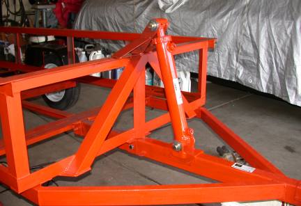

This is what I came up with for the dump cyl and front reinforcement for the bed.

Nice pic's there Scoot,the new color looks great.How high will that cyclinder pick up the front,is your pivot point at the very back?Will it have a wood or steel floor?Looks like your doing a fine job.You must also do some welding,looks like it's been your winter project.Have fun keeps use posted
   / Size of trailer you pull behind BX #10
The cylinder is a 12" stroke it will put the back of the trailer on the ground and with the three point up it should be a good slope. The pivot is only about 15" back from the front of the trailer box. I am going to use plywood for the floor. I have been doing projects all winter, I just ordered all the fittings and hose to hook up the two spool rear remote valve, the trailer cylinder, and the cylinder I put on the back blade. I have to get this stuff done because the bike will be out soon.
