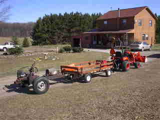

here is what I pull for getting fire wood.
   / Size of trailer you pull behind BX
#14
Nice pic there Chochauler,sure looks like you can get a lot done with that fire wood set.Do you just do the wood for your self or do you run fire wood bussiness looks like you have the capabilties there. Thanks for the safty lecture John Bud some times we all need hear them again.Red
