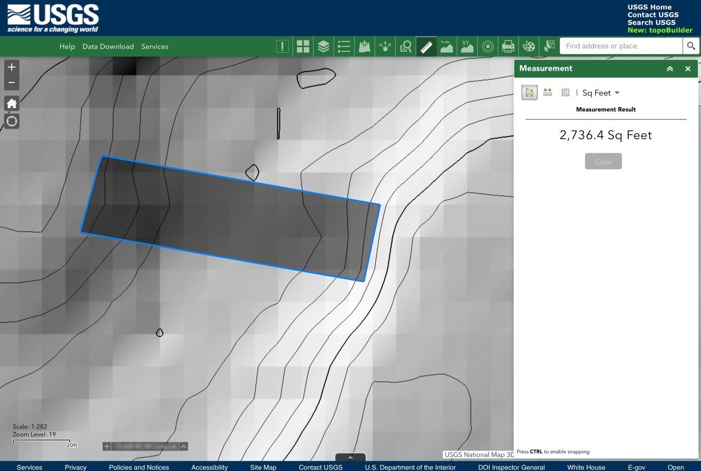

We have a small stream in a valley we want to span and originally I was thinking a bridge, but realized everywhere close by the spanning of streams was done with causeways and culverts due to the silty/sandy soil. There are three ways to solve the issue, create a ford, add a causeway and culvert or add a bridge.
A resource I've also found useful for planning this sort of project is the USGS National Map Viewer that allows you to overlay layers, adjust order and transparency to see pretty detailed Lidar images of your project. This shows the use of a measurement tool showing the area off a potential causeway overlaid on lidar layers, "hillside stretched" and contour lines which for our area are very accurate in our area, though the wetlands data seems offset from the lidar data, though accurate in the aggregate AFAICT, just annoyingly mis-aligned.

The county, state (and probably the feds) would have a heart attack if I dropped a culvert in the stream and backfilled.
This creek is a tributary of the Patuxant river (part of the tidal Chesapeake Bay),, The creek on my property is not tidal, but about 1/2 mile down it is.

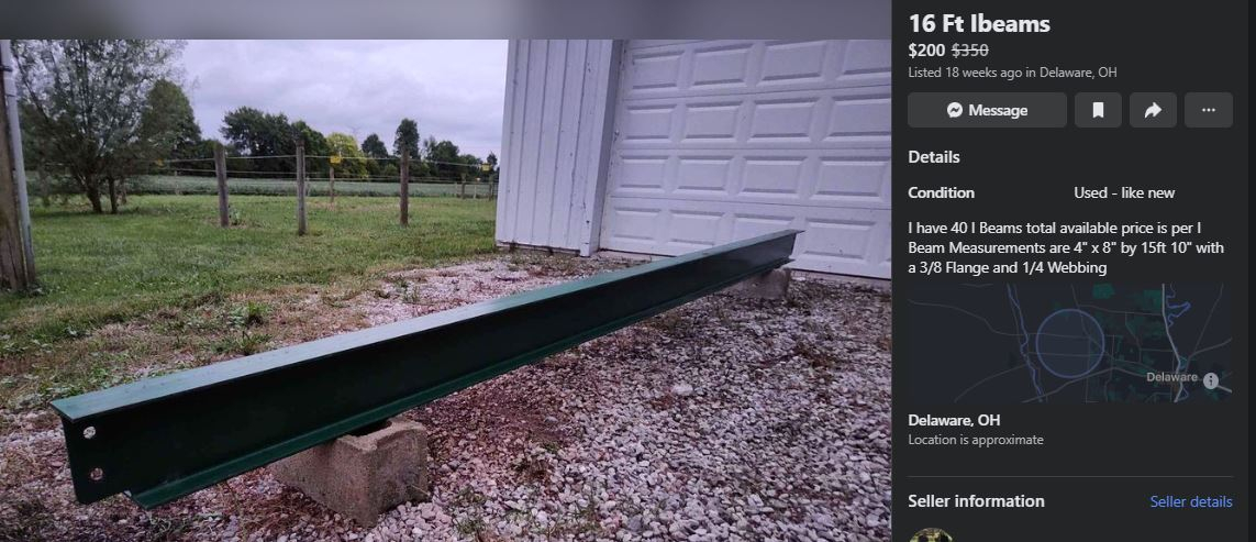

Did some final measuring today.
Looks like the best spot the top of the bank width is about 12',, so adding 2' on each side to get away from the bank,, I will need 16' beams.
I'll be dropping by the scrap yard later this week.
With the 16' beams, my clear span would be about 14-15'
Now how to keep them from twisting.
