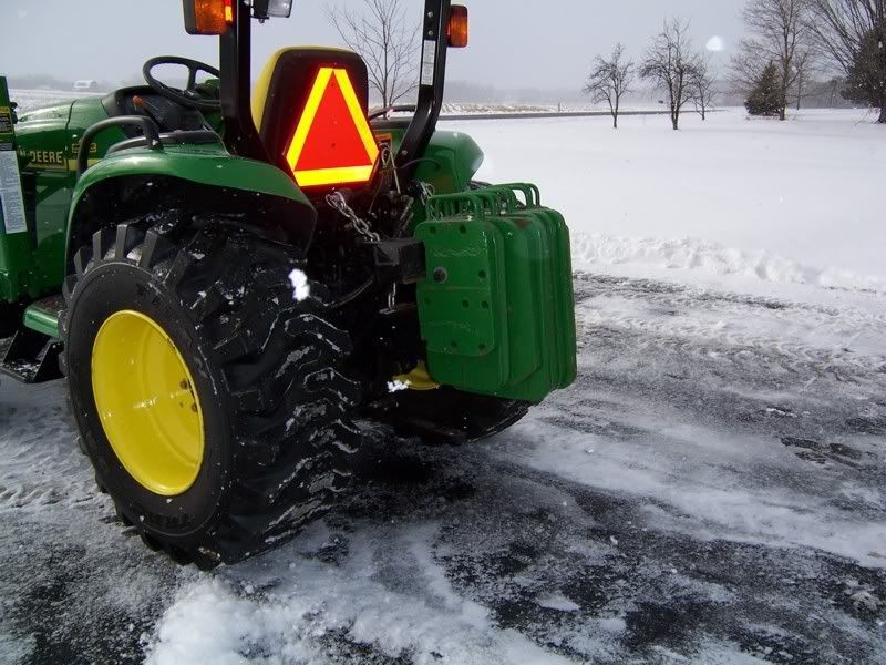

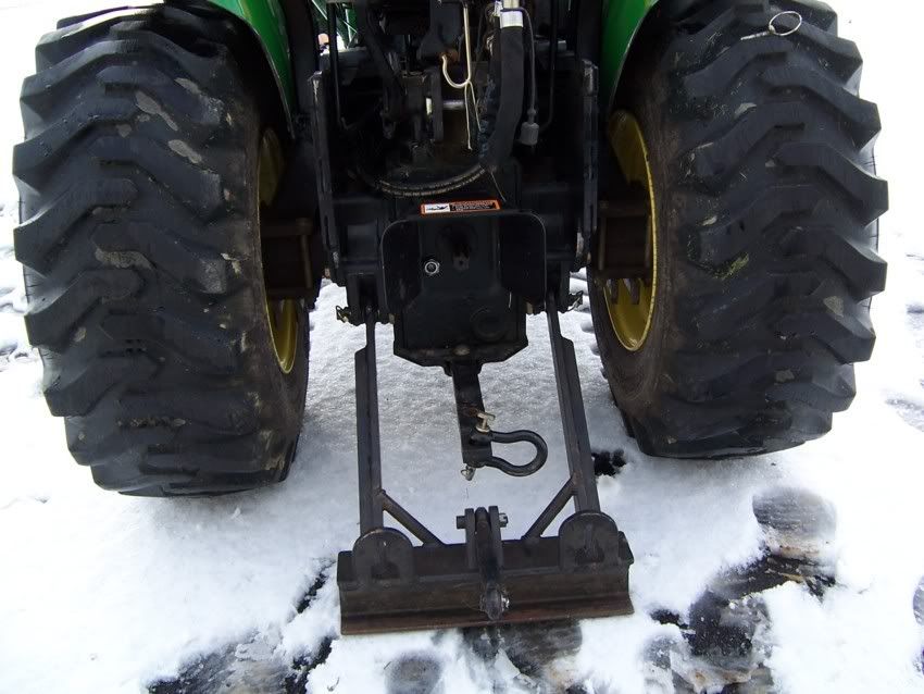

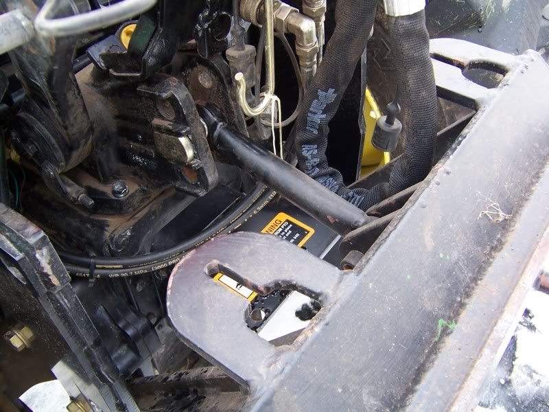

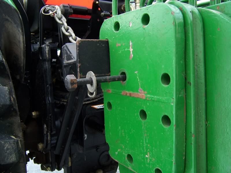

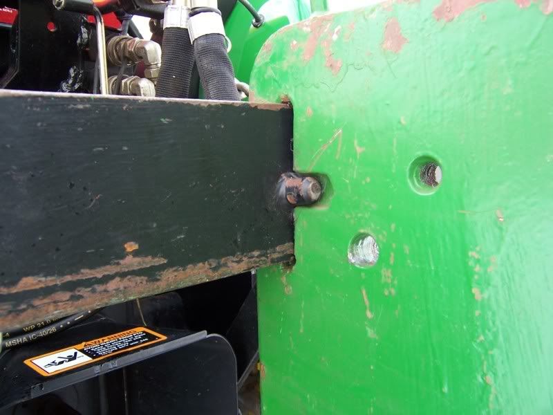

Well ,not sure how much fabricating you want to do,but here,s the weight setup I made a couple of years ago.I know ballast boxs seem to be pretty popular,but I really didn,t want one for two reasons(I,m sure I,ll get attacked for both of them!).First I didnt want to leave the weight on the hydraulic,s all the time.Secondly ,I didnt want something I needed the tractor to move,since I like to keep most things inside,and if I can move it by hand I can store it anyplace with out having to have a path for the tractor to get to it.So that being said I made a bracket that mounts to tractor at attaching points for 3pt hitch arms (arms removed).Then made suite case weights that slide on bracket.They take less than 10 mins to attach or remove,there in close to tractor,and store easily.Ya its just under 800lbs right now and may make a few more weights to get just over 1000lbs.One more thing,the chains in the picture are not holding any weight,there just kinda a safety incase top link ever broke.They would make a pretty good gash in the blacktop,the chains really arent neccesary.
