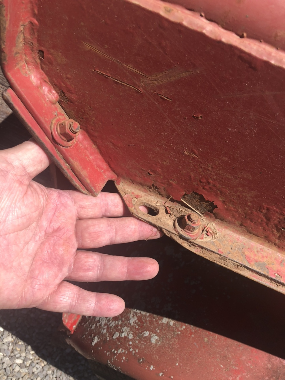

Bought 20 year newer 286 bush hog this spring. It’s skids had worn thru at the front corner. More from improper adjustment than hours of use. OEM parts too expensive.
Two piece, front with bend 2.5” wide and 1.5” wide side strip.
Have 3”x0.5” CR flat bar scrap to repair. Cold rolled will not bend 45degrees cold before cracking. Takes heat. Have to countersink for flathead screws.
Have similar issue with EA land plane. Both winter time jobs.
Been over thirty years since I ran hard surface rod. Remember even new rod ran better fresh out of the oven. $40 of rod should do both repairs and last for a couple of decades.

The skid shoes for my rotary cutter are $50 each. The ones for my LPGS are $80 each. I need two on each implement.
I understand those that say improper adjustment on the rotary cutter leads to wear but the LPGS is DESIGNED to drag on the ground.
Anyway, I bought 10 lbs of hardfacing rod for $110 (the smallest amount the LWS would sell). I plan to run some beads and see how that works.

Thanks for that.
I quickly found out that I need to build the skid shoes back up before running hardfacing on them. When I tried to lay a bead down, it burned right thru. I thought "That is 1/4" metal, why did it burn thru".
The worn part ain't 1/4" no more. If it was, I'd not need to do anything....DUH!
This has become more of a "Welding and grinding practice" project but, that is OK. If I totally mess it up there is not much lost.
