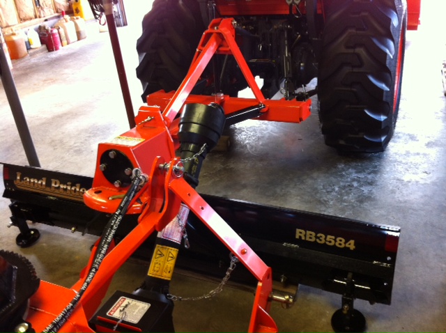

I have the same blade and use it for dirt and snow removal, get the shoes you won't regret it.
DevilDog

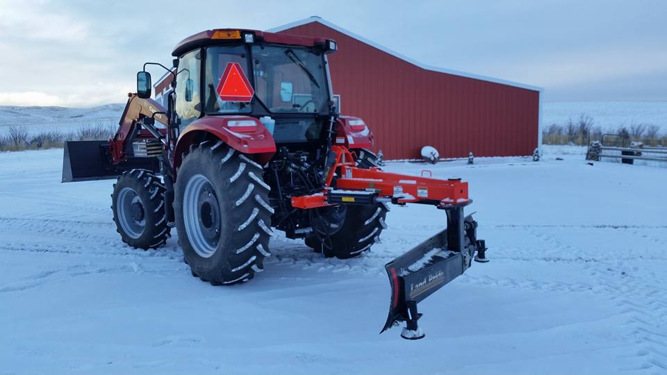

Here is a picture of my blade with the shoes.
