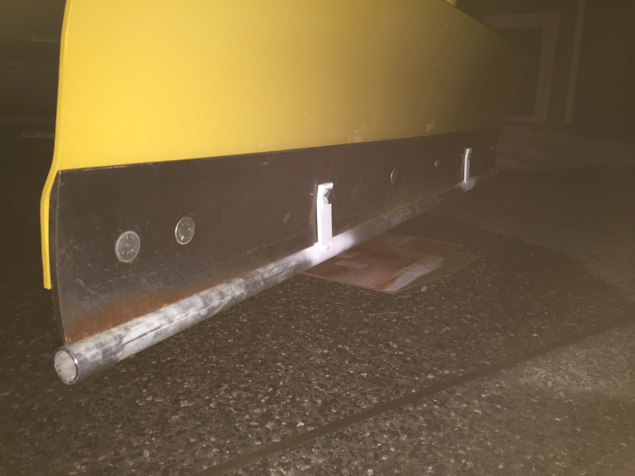

Do a search here -- there are a lot of threads with solutions. The two popular ones are replacing the steel cutting edge with a piece of stiff rubber (horse stall mat, conveyor belt, etc) or putting a pipe over the cutting edge. I have tried both, and like the pipe the best. Here's my most recent version:
In my experience, skid shoes will also help but will be much less effective if the ground is still soft and unfrozen (they will dig in and leave ruts). For that situation, something along the entire edge is preferable, like the pipe or rubber edge.
   / Skid shoes on a scrape blade #4
By the way, the pipe trick works best if you have a way to put a slit in the pipe so that it can slide over the edge, rather than use brackets as I did. However, that is not easy with metal pipe unless you have access to a plasma cutter. Last winter I used PVC pipe, which was easy to slit on a table saw. It worked well, but wore out quickly -- basically a one time use. I made 3-4 of them to get through the winter. I am hoping the metal pipe will last longer.

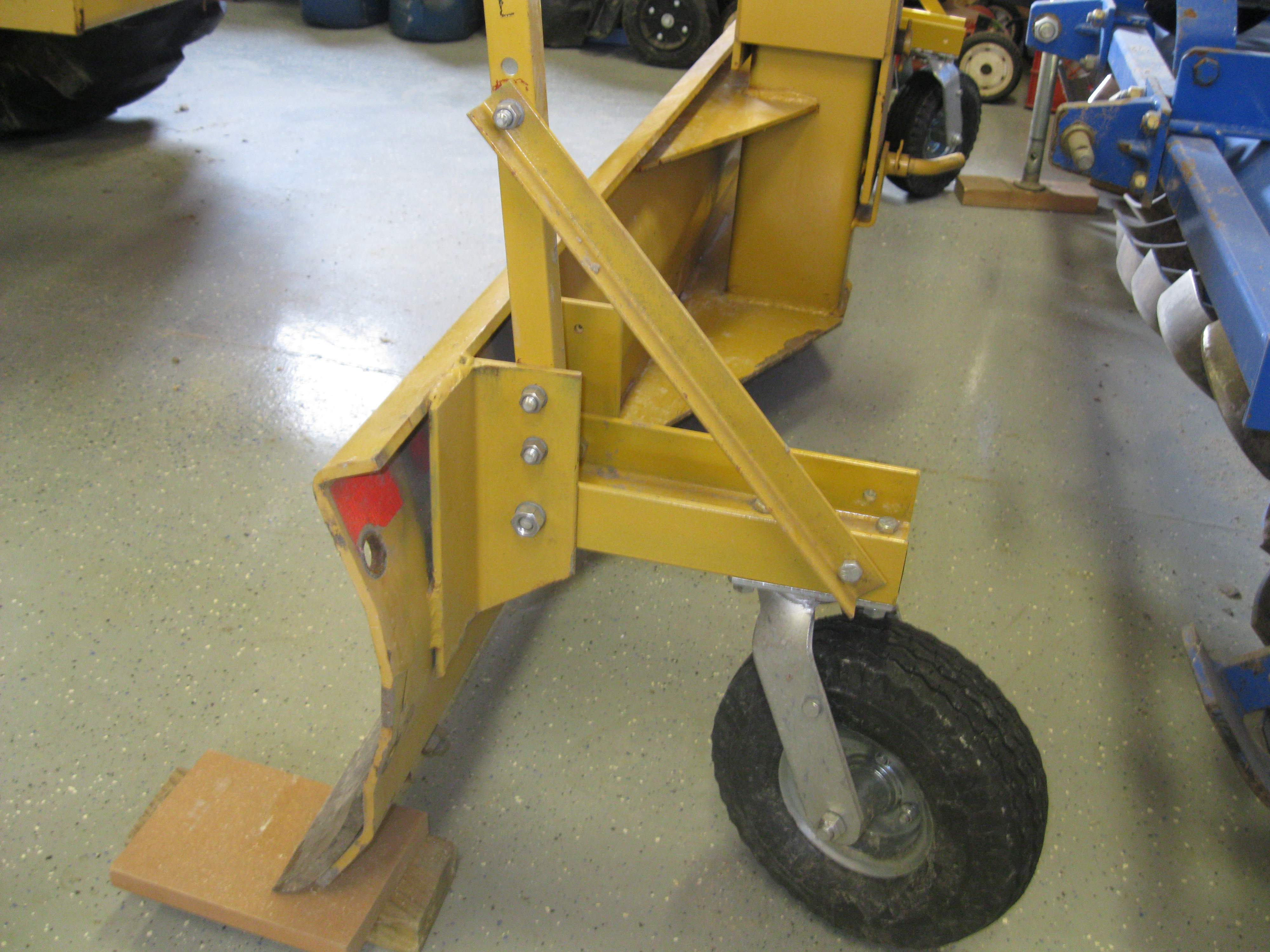

I do several gravel driveways and I added two caster wheels to the ends of my blade. I have a 7ft bush hog and with the casters I have no problem with the gravel. I can adjust the top link to cut down on concrete or leave and inch of snow. With the caster wheels I can reverse the blade or angle it. I'm not having any luck posting a picture. I'll keep trying.
