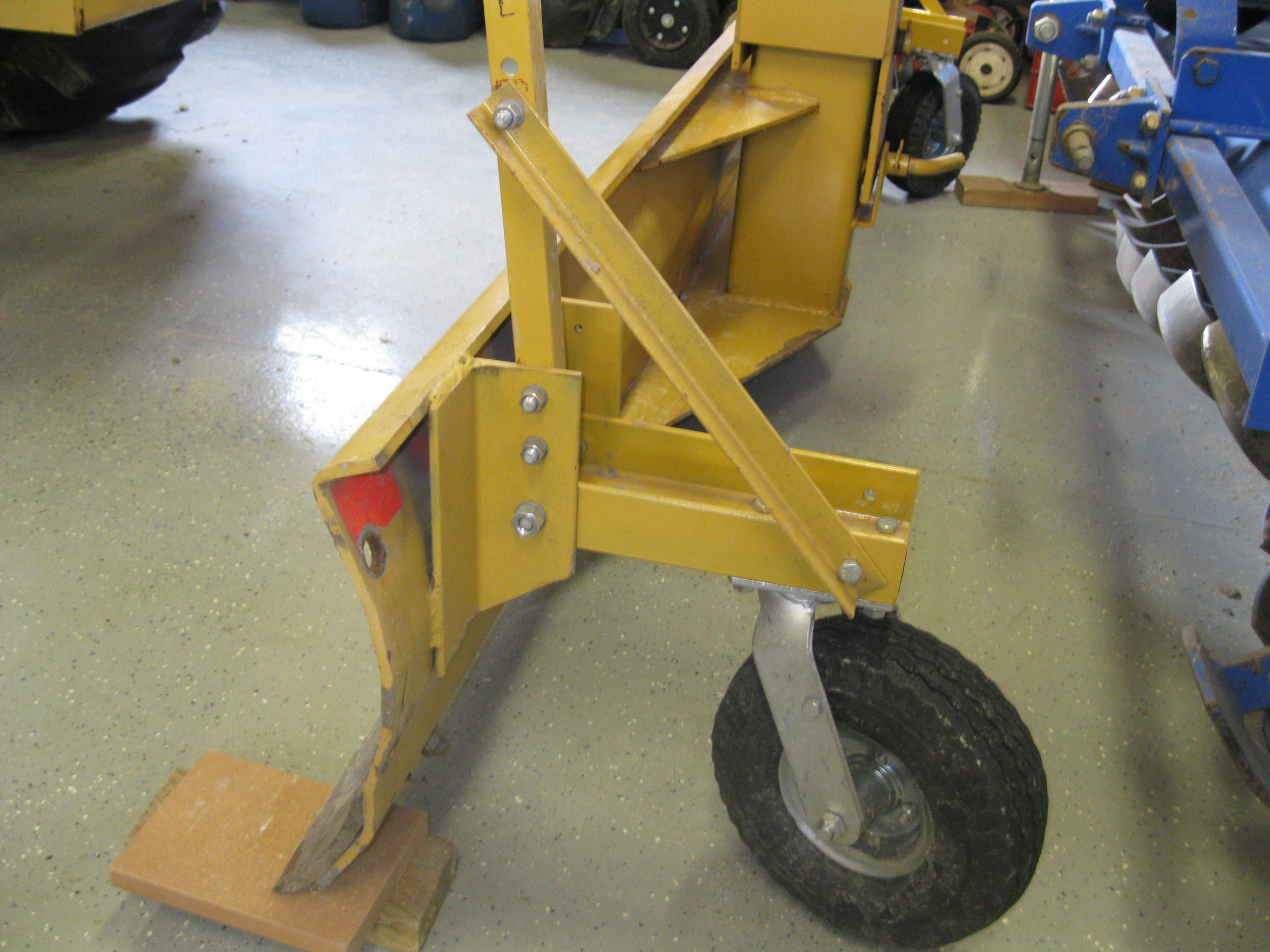

Skid shoes on a scrape blade
   / Skid shoes on a scrape blade #11
   / Skid shoes on a scrape blade #12
I do 2 things to help with your situation. First I turn the blade around so it arc's the opposite way. This keeps it from digging in. second, I have a manual 4-way blade that allows me to tip the blade left/right as well as angle it. I angle it at around 30 degrees but I just pull the other pin and allow the blade to follow the contours of the road. This eliminates any high pressure spots. Have no problem with pulling gravel now.
I do the same thing in regards to running the blade backwards so the curve is in the direction of travel. I have thought about going with the pipe on the cutting edge but I find that even though I normally plow backwards, I occasionally have to pull the blade and allow the cutting edge to dislodge ice and thick packed sections of crusty snow.
If I had the pipe over the edge there are many sections where the blade would simply ride up and skim over the hard packed snow.
