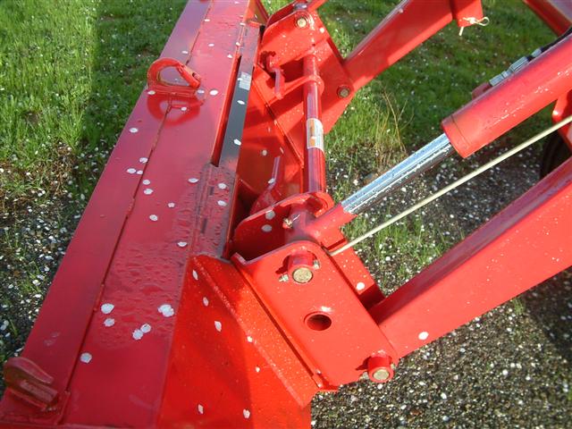

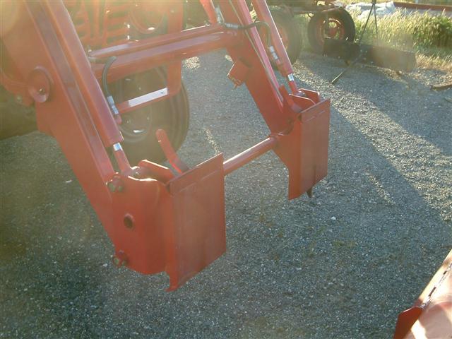

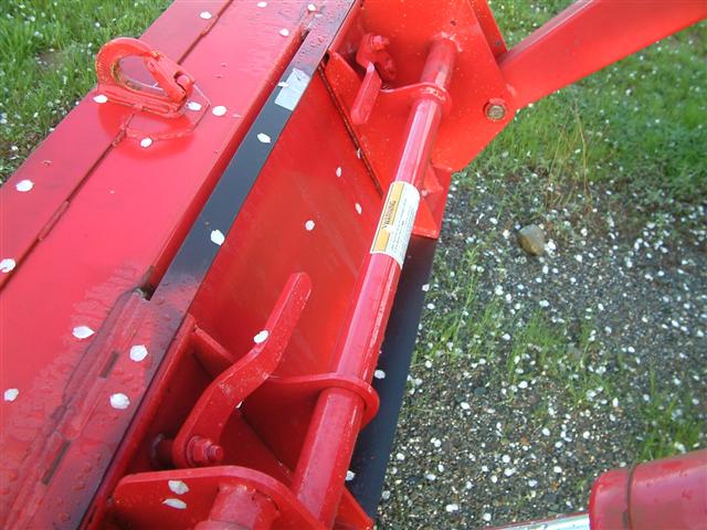

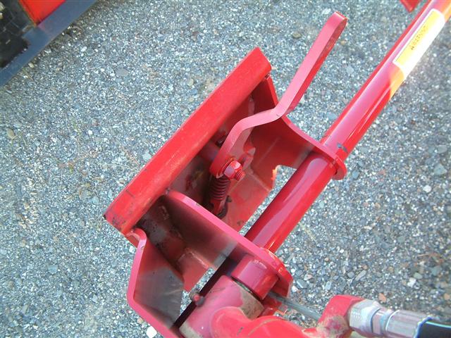

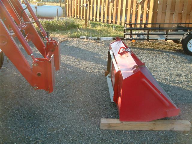

Here's the SSQA on my 2008 Mahindra 5525--cost ~$900 installed
DSCF0110 (Small).JPGDSCF0111 (Small).JPGDSCF0112 (Small).JPGDSCF0181 (Small).JPGDSCF0182 (Small).JPG
The spring loaded retention pins look like the most complex part of the assembly and they are important--you don't want your FEL bucket coming detached while hauling a load (don't ask how I know:confused:).
Good luck
