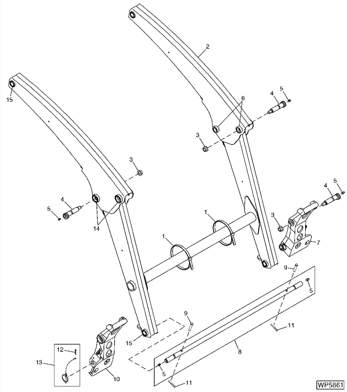

I have a 3720 with a 300CX loader. They put on a JD skid steer adapter on the loader arms. It worked fine until I had them put the 3rd SCV on and hook up my snow plow. The first time I took the plow off to put my bucket it on, I noticed the arms were not moving at the same speed. This makes if difficult to line them up together to get on the QA plate. I showed the dealer and said there might be air in the hyrdaulic lines and should work its way out. It has been 2 months now and still doesn't work right.
Also, when I had my New Holland the ATI skid steer adapter they used was one solid piece, The JD is two. I thought about having someone weld a piece across them to make them go in sequence.
What might the culprit be so I can tell the dealer?

NYBOB, there isn't anything wrong with your hydraulics. Its not air that causes the cylinders to work out of sync. Its just the way the cylinders work. Since they are separate and not tied together with a bucket they will not retract or extend at the same rate. Just something you have to deal with. Try either retracting them all the way or extending them all the way. That way the brackets will be the same on each side. Again there is no fix and there isn't anything wrong. All loaders will do this. I guess a solution would be to get someone to weld a piece between the two brackets so they work in unison even with no bucket.

There is nothing that assures the cylinders will move together. The one that moves easiest will take the fluid unless they are mechanically joined, or the fluid is metered to each via a flow divider. I dont know whether the latter is normally done on tractors. As you say - join them. Mine has a good sized torsion tube between the 2 sides, fully crossing each clevis bracket to prevent possible twisting of the clevis ears if it were to see hi twist loads.
Not "quite" true.
There is a rod that runs between the 2 QA shoes that is supposed to keep them somewhat in-line, look at part #8 and #9 in the attachment. It is VERY easy to sheer one of the pins(#9) and then the shoes will not move together and drive you crazy (been there, done that!). I hope this is your problem!

I have tried extending and retracting several times. I have worked the hydraulics everyway I coudl think of to exercise them. The odd thing is they used to work in unison. I would take my bucket off even before the snow plow was purchased.
It makes it tricky to angle the ends into the QA plate. My NH with the ATI adapter was a breeze compared with this. Maybe my dealer would weld a piece on to make it work together.

NYBOB,when I said to extend them I was meaning to leave them fully extended. Running them in and out doesn't help them get back in sync. When the cylinders are out of sync I have rolled the brackets into the dump position and then hooked the one side into the hook that was in the best position and then rolled the bracket back towards the closed position. Since there is more resistance on the now hooked bracket the other side can now catch up and be hooked. I think the simplest thing to do is to get a piece welded between the to brackets so they always move in sync. Problem solved!

I did look at the pins as suggested but they look to be fine. I am going to have my dealer look at it.
