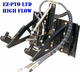

Here are some..
   / skid steer attachments on tph #6
You need three point to MALE Skid Steer. Then SK implements could be fitted to the back. I havent seen these but would sure like to have one.

Here are some..
Far as I can tell those are all made to go on a male skid steer connection and convert it for 3pt implements. Thats backwards... He needs it to go on a 3ph and convert it to use SK implements.
larry
   / skid steer attachments on tph #10
larry
The original poster said for front and back. I have not seen the the 3ph conversion, that allows one to convert from 3ph to male skidsteer. Most skidsteer attachments are made to be pushed. I made an adapter to go from skidsteer to 3ph, and also to use Power-Trac attachments.
