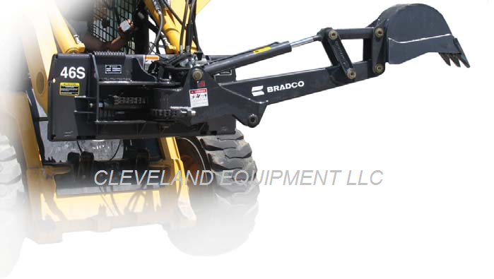

There is also a boom mounted backhoe:
And a swing style:

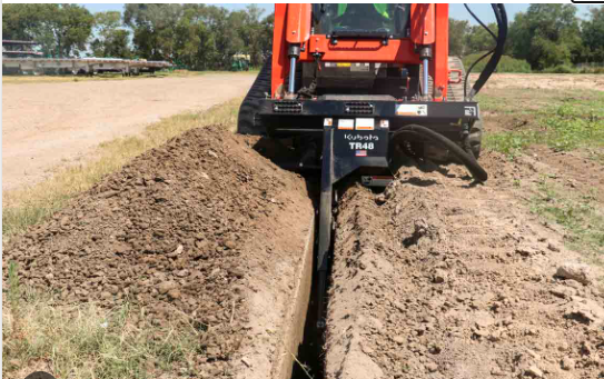

How about a trencher attachment?:

I've run both. The backhoe attachment comes with 2 types of stabilizers. There are plungers which go straight down and true outriggers which fold out and down like a backhoe. You want the backhoe type.
There is a learning curve and it's true a guy could tip the machine while not being protected. The trencher is a safer bet if everybody stands clear. Know your ground. There are chains for soft ground and chains for rocky ground.
Also get a long bar. 1/3 of it won't be in the ditch.

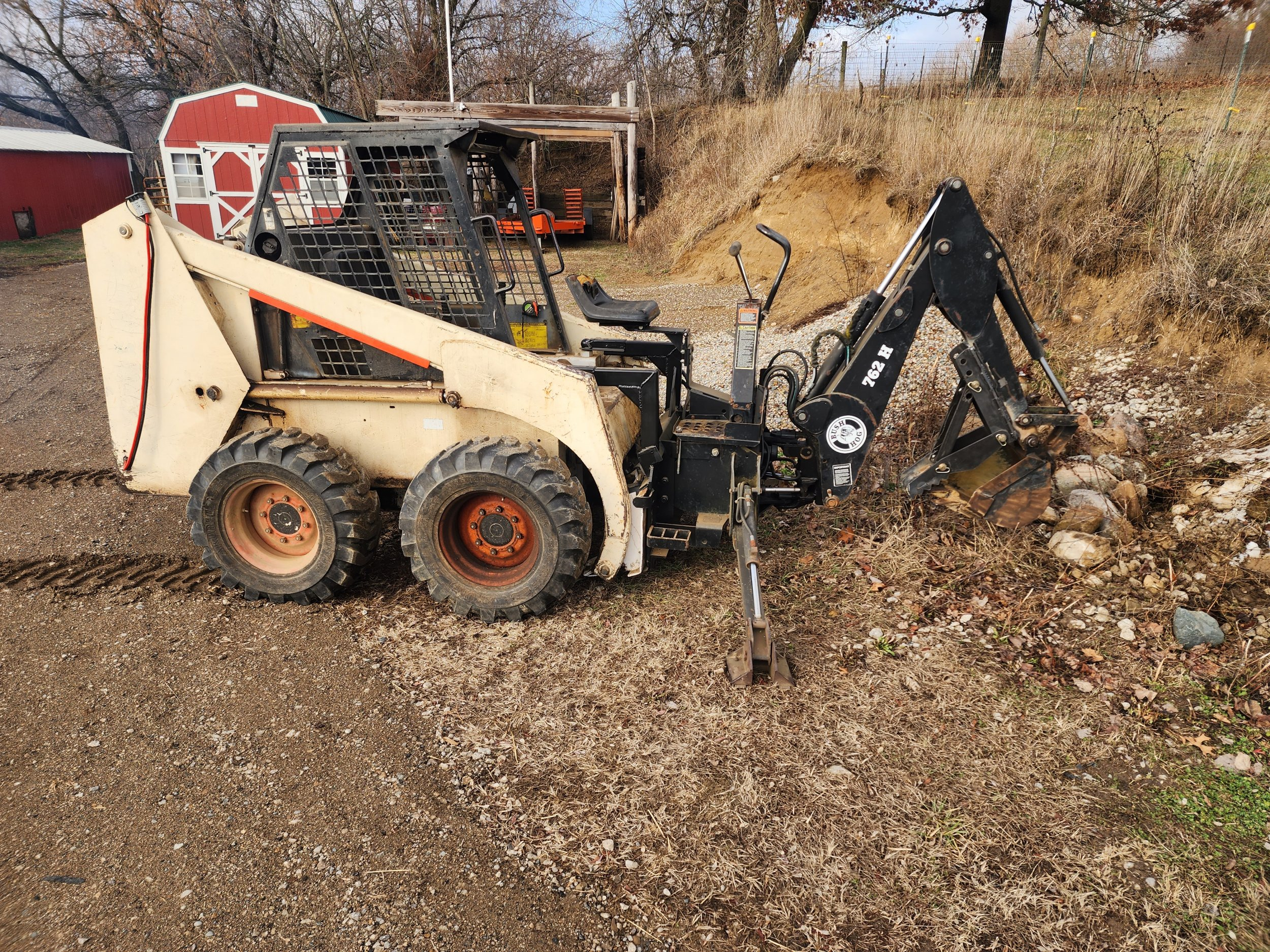

I love my backhoe unit on my skid loader. It is not as strong as a mini-ex for me ot was a no brainer since I got the attachment for about 3k vs 50k+ for a mini. I had to fabricate the attachment for it to tie into the factory BH mounts. Alao, I added a mechanical thumb and built a quick attach and root rake for it. If you have to buy a skid specifically for the BH unit and aren't using it for anything else I would just buy a mini. But if you already have a skid or have use for it beyond the BH I'd do it.
