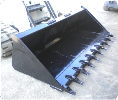

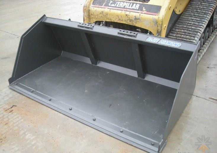

I have a Blue Diamond toothed bucket and it seems well built. One nice thing is that the teeth are flush on the bottom and it backdrags very smoothly. Unlike buckets with toothbars that leave grooves when backdraffing.
