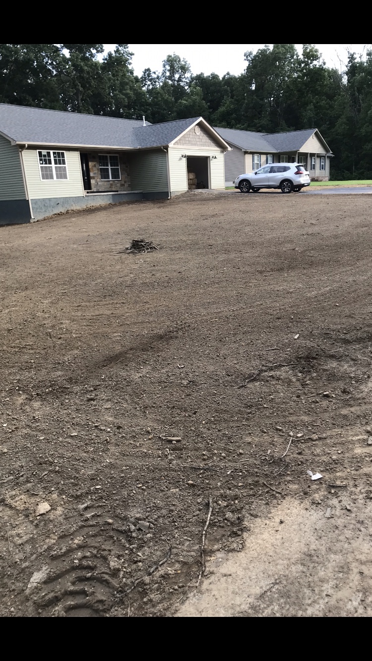

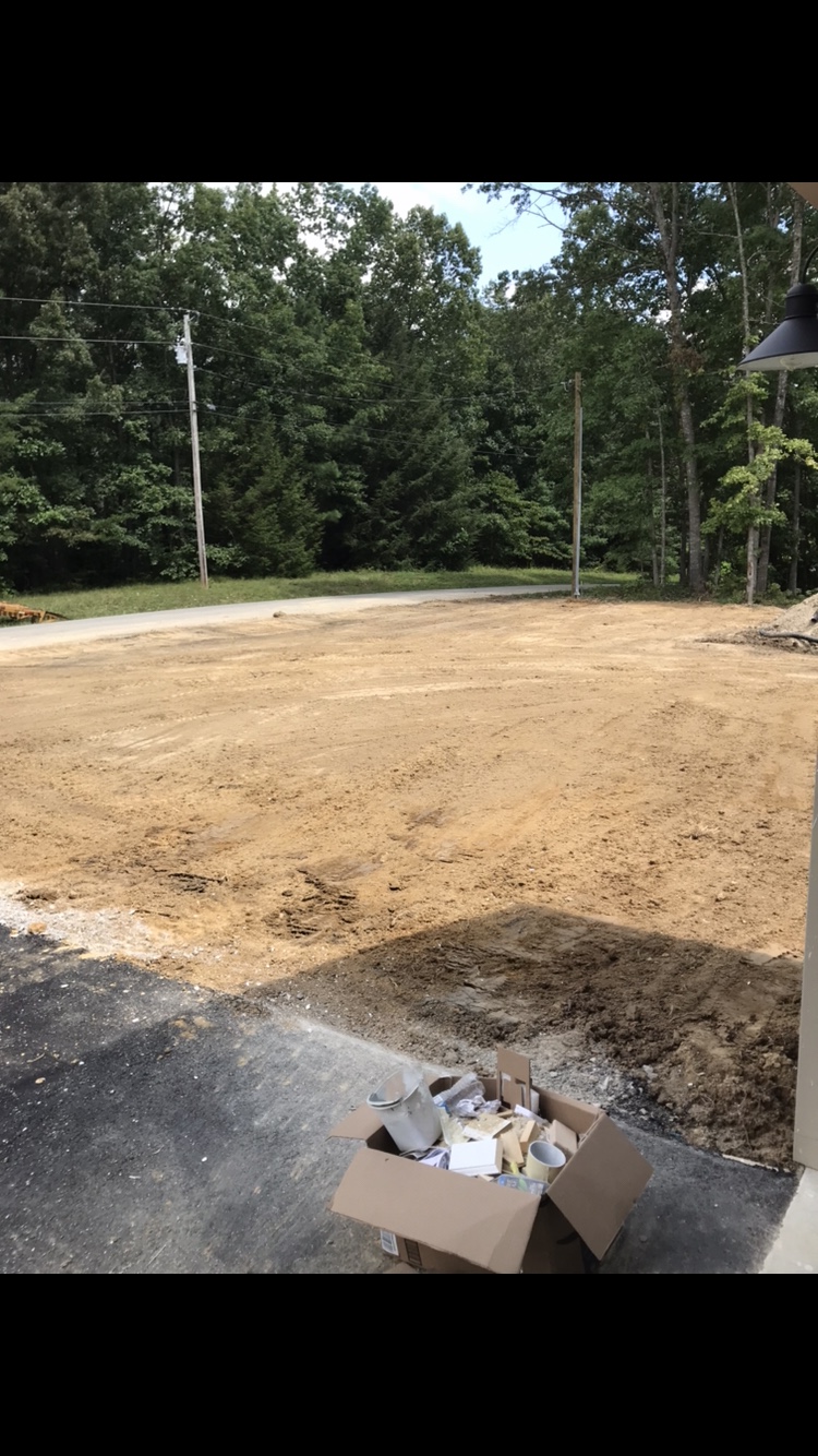

Looking for some good advice for grading with just a skid steer bucket. Just picked up a 95-2s for rough grading and leveling. Also will be doing some finish grading & spreading top soil with it. Anyone have some good tips and tricks to share? Played on it the weekend and it way different than using the tractor. Tried keeping the blade level and not using the whole bucket but only half to try and get things level but didn稚 work out so great. End up back on the tractor to finish. Thanks
   / Skid steer grading advice? #2
Once you get good with the 95 you’ll never want to use the tractor for dirt moving again. You want to cut out humps going forward. And you don’t want the bucket angle too aggressive. The bucket bottom needs to be flat with what you want the finish grade to be. IMG_8498.JPGIMG_8499.JPG

For some reason I was thinking if I start level like stated above and go into the cut. Once cut and bucket full the loose in bucket would fall out into the lower areas. Also, found it hard to know if you were still on grade once the buckets cutting edge was covered with dirt. So I wouldn稚 know it I needed to adjust the angle of the bucket to keep from cutting more or less
   / Skid steer grading advice? #5
You can kinda judge by the rate the bucket is filling up. It’s best to make a few light passes. Another method I used was to use the teeth back dragging to break up the dirt to the depth I wanted and then scoop the loose dirt off the top.

I have a Cat 246 that started life as a tire machine. Now has a full set of tracks on it.. Tracks are by far better for grading. Also a tooth bucket to rough grade at first. Im not a fan of back dragging to set a level grade. I get much better and faster results with a 1/2 full bucket and going forward like a dozer. Doing it this was I can get ground flat as a pool table
