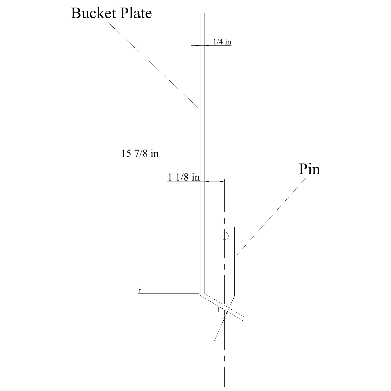

Got it now.. I'm the opposite of you.. I'm trying to now have to modify every implement I get so it will fit my tractor. Rather make the tractor conform to the SAE standards.
I did go out and measure the distance from the bucket plate and the center of the pin. It is 1 1/8". That same measurement on the tractor that worked was 1 3/8". In reality ( I could be wrong here) but mine should actually be looser than the one that worked.
Attached is a quick drawing. It will need to rotated 90 CC.

UPDATE..
I did some measuring and found that my pins are about 1/2" too long. I used the spec that was posted here on TBN (SAE J2513). It shows that the distance from the top to lower edge of the mount should be 16 5/8". If I measure from the top on MY mount on the tractor to the center of my pin I get about 17 1/4". I have a rather long taper on my pins, approx. 2 1/2".
Guess I'll either take it to the grinder or might take to a friend who has a real machine shop and he can fit perfectly. That mean taking the bucket and the mount on the tractor over to him. But when he get done I know it'll be correct.
