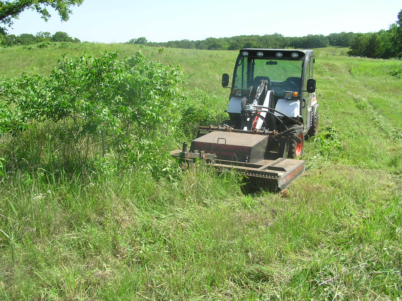

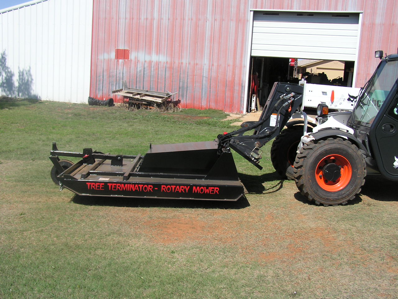

This 84" is two feet wider than the Toolcat. Makes it good for getting close to stuff:

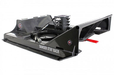

This is my current pick, looks like a good mower
If you are mostly cutting grass I think it's probably a gook pick but if you cut much brush you will be happier with one that has carbide teeth on the bottom of the blade carrier for shredding the debris into much smaller pieces and better demolition of the stumps for a better finished product, that unit won't have any problem cutting the brush as it has a heavy blade carrier which will transfer plenty of momentum but it will leave a lot of large debris. Have you checked out MTL or Rut Manufacturing? Also if you don't mind, what machine are you going to run it with?
