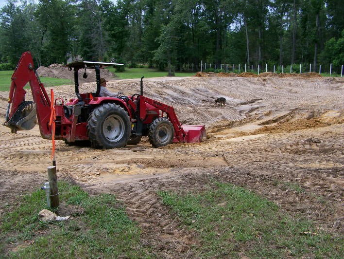

I always thought a backhoe would be the ideal pond tool. That is..............until I bought one and realized it was not. I dug the pond basins of both of my ponds with the front loader bucket on my Mahindra 6520 4WD. The first smaller pond, I dug to 4 foot depth with the loader then to depth with the backhoe. But I would have to dig and dump it 90 degrees, then drive out and turn around and go it to remove the spoils with the loader. Lots of wasted time and dangerous turn arounds when the bucket was full. 1-9-09 Mahindra with little turning room.jpg

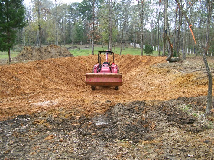

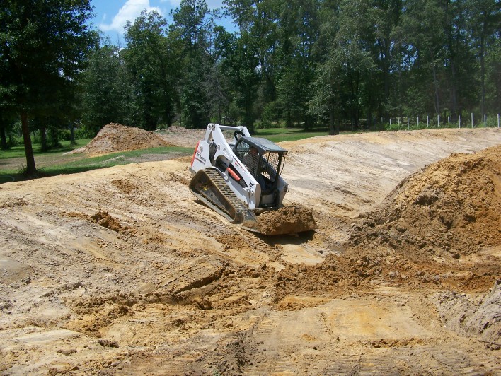

My second pond, I dug down to 7 feet with the loader bucket. 7-9-12 Digging clay with Booger and flagged faucet.jpg Both ponds, I just used the bucket as a dozer would and pushed the spoils over the dam, then carried it where I piled it. It took forever and to me moving dirt is so boring. But deep in the basin, the front tires kept sinking with a loaded bucket. So I rented a mini track loader, a Bobcat 770. I could then haul out the wet stuff at the bottom. 8-4-12 Bobcat Backing Up In Tilt.jpg I loved the Bobcat, as my foot print sunk deeper than the tracks with a loader bucket full of dirt. But you still had to travel to pile the spoils. I made piles close to the pond and am still moving them to this day to spread them out.

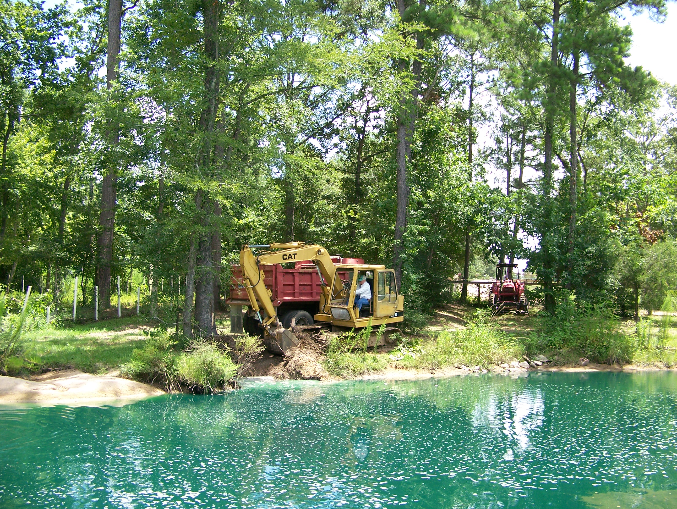

Now, I bought a CAT E70 excavator and Ford dumptruck to enlarge the pond, which is a work in progress. I love digging and dumping straight into the dumptruck! But I hate driving the dumptruck. It cuts down on fun digging time. I need a driver! 7-31-16 CAT Moving Shore Back Into A Finger.jpg7-3-16 CAT Digging Up Huge Sweetgum Tree.jpg
