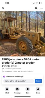

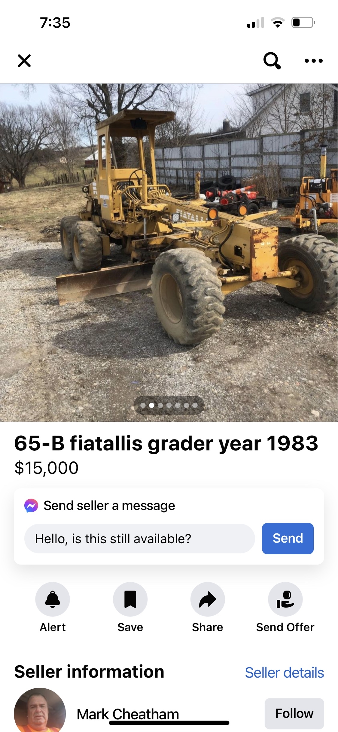

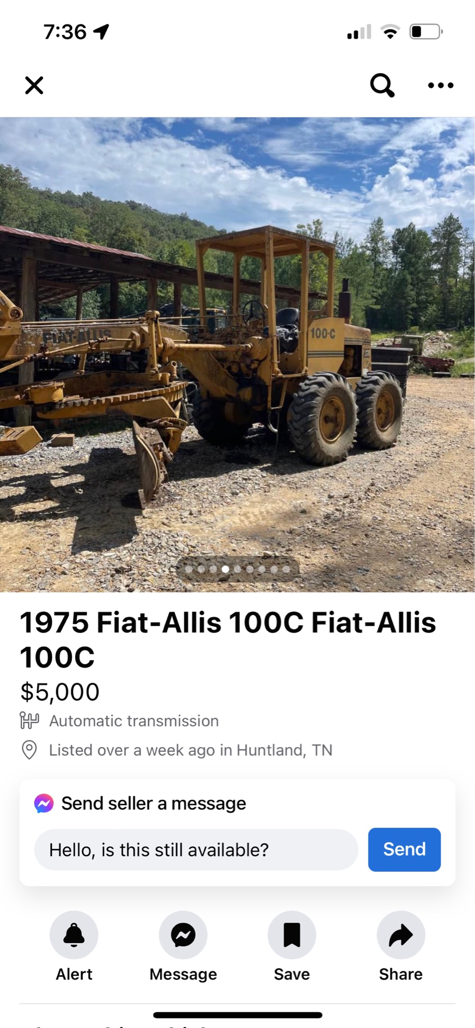

I'd flag that ad. Looks way to good to be legit. For $10k I'd buy it and ship it to CA. ;)
It looks legit enough to me. Old graders don’t sell for much. If I had a legitimate need for one I’d buy one. Here’s what I found in 2 minutes of searching. I could see myself owning a midsize grader that’s short enough to transport on the trailer I currently own.
