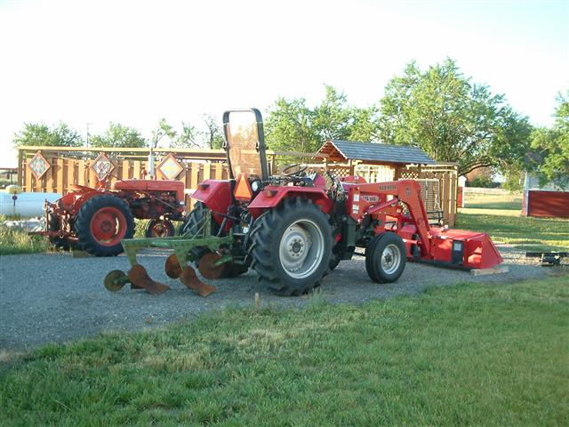

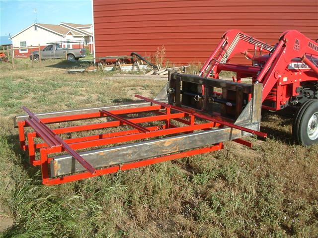

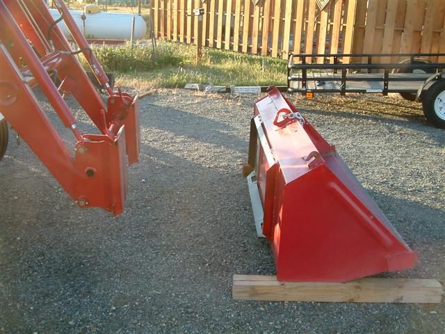

I have a 2008 Mahindra 5525 diesel tractor (54 hp engine, 45 hp pto, 2WD, gear tranny, power steering) with the ML250 FEL (6-ft wide bucket, 2950 lb lift to 10.5 ft) and a standard skid steer adapter on the FEL arms. Can't beat that setup for versatility. The only drawback compared to a large skid steer is the flow capability of the hydraulics (my 5525 has 10.5 gpm, large skid steers can be double this).
A nice advantage of this setup is how easy it is to build your own attachments that fit onto the skid steer adapter--like this bale squeeze I build several years ago. Saved about $4K by going the DIY route.
Good luck in your quest.
