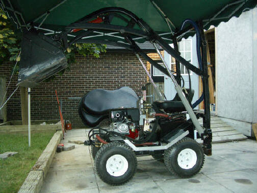

i am in the process of building one just for the fun with my spare time. Unfortunately, all my "SPARE TIME" are taken up by better half with projects around the house.
I am building a mini-version, one that can fit thru 36" of space and about 52 inches long. ( chassis only ) without the front end loader. It is going to be a modular design that I can attach various attachments to it, including a backhoe, frontend loader, and a snow thrower. It is powered by a 13 hp honda motor. The chassis is build with 2x2 1/8 tubing with 18" wheel and chain drive with 2 hydraulic motors. I will keep you posted. I am also putting a 5 wheel option with steering so when I work on the yard with it, it does not chew up the lawn. I have also tried contacting chris but without luck. All the metals are from scraps lying around, so some of the design may look a little strange. feel free to contact me any time by email candubob@sympatico.ca

Finally found three weeks to complete the skid load. All made of scrap metal lying around except for the bucket. I ran out of angles and have to buy some. Here is the picture. More details later. Total hours about 100 hours.

Wow, please start a new thread and post lots of specs and pics of yours. That looks like a great machine!
