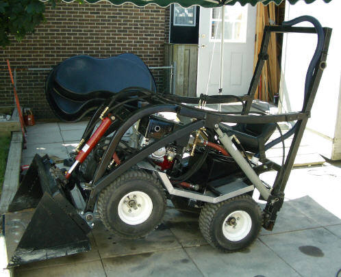

i am in the process of building one just for the fun with my spare time. Unfortunately, all my "SPARE TIME" are taken up by better half with projects around the house.
I am building a mini-version, one that can fit thru 36" of space and about 52 inches long. ( chassis only ) without the front end loader. It is going to be a modular design that I can attach various attachments to it, including a backhoe, frontend loader, and a snow thrower. It is powered by a 13 hp honda motor. The chassis is build with 2x2 1/8 tubing with 18" wheel and chain drive with 2 hydraulic motors. I will keep you posted. I am also putting a 5 wheel option with steering so when I work on the yard with it, it does not chew up the lawn. I have also tried contacting chris but without luck. All the metals are from scraps lying around, so some of the design may look a little strange. feel free to contact me any time by email candubob@sympatico.ca

Finally found three weeks to complete the skid load. All made of scrap metal lying around except for the bucket. I ran out of angles and have to buy some. Here is the picture. More details later. Total hours about 100 hours.

Wow, please start a new thread and post lots of specs and pics of yours. That looks like a great machine!
Ron
/ Skid steer project #11
I'll second that!
We need lots of details and closeup pictures from all angles. And videos of it in action.
And CAD plans.
And ...
Well, OK, whatever you have time to post would be appreciated!

Will try to get more pictures. It's a pain because the size limitation of the board I have to reduce the picture drastically.
Was out digging ( at someone elses house since my better half will not let me dig up her yard ). I wanted to try out the braking system on a step hill. Put in Deadman brake so when you let go, it stops the vehicle. Also make it unnecessary to have a parking brake.
no problem climbing a 30 degree hill with a full bucket of dirt. The bucket is about 18 x 22 deep x 36 inches wide.
Dugged a driveway out in about 2 hours that's about 10 feet by 30 feet. Need to modify the bucket a little bit by making the upstoke floating to getting better levelling and control. The skid is small and light weight, and with such a short wheel base (30 inches), it's hard to grade the ground properly.
Will try to post more details. Right now, heading back to the shop to do some welding.
