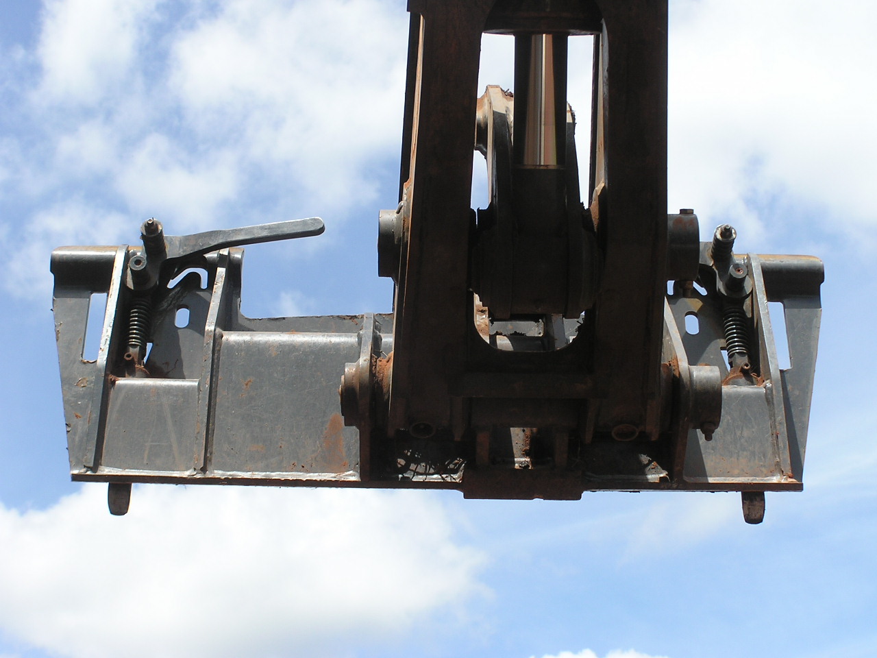

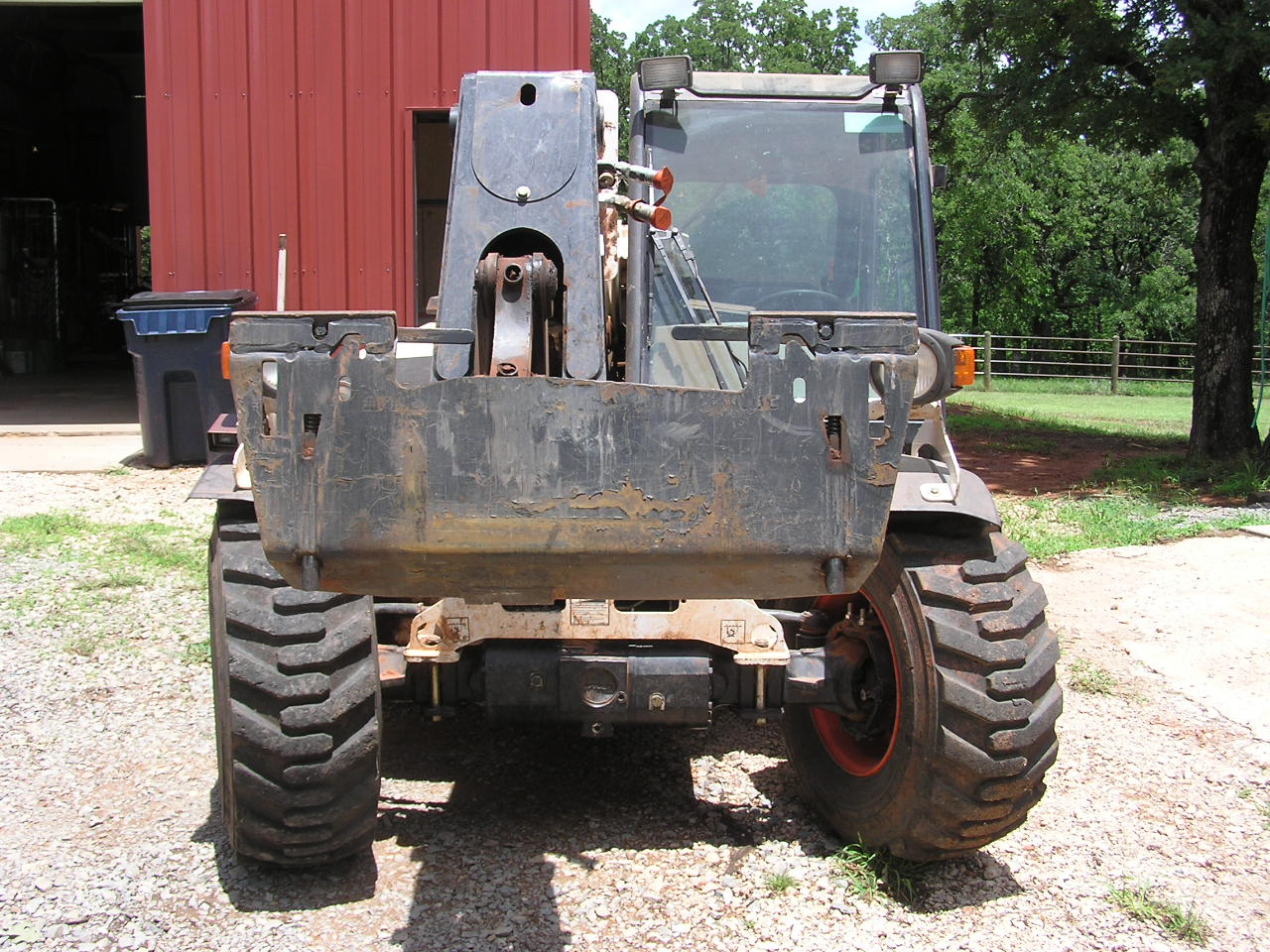

I have a older FEL (Kelley 500) with a single dump cylinder; what are the pros and cons on building an SSQA adapter for it? Would it be better to convert the FEL to have two dump cylinders?
/ Skid steer quick attach adapter #91
Pro: Almost everyone that has SSQA likes it.
Con: Lose some lift capability.
Not unless it has weak rollback.
/ Skid steer quick attach adapter #92
The rollback seems strong. My concern is how strong do I need to build the SSQA adapter for the single dump cylinder in the middle vs having the two cylinders in-line with the lift arms. What is your opinion: would it be easier to build a stronger adapter or add a second cylinder? I am already planning on re-plumbing the FEL anyway.
/ Skid steer quick attach adapter #93
I think it would be easier to build the adapter, than get the cylinder size, stroke and mounting locations right.
Mine only has one cylinder :D.
