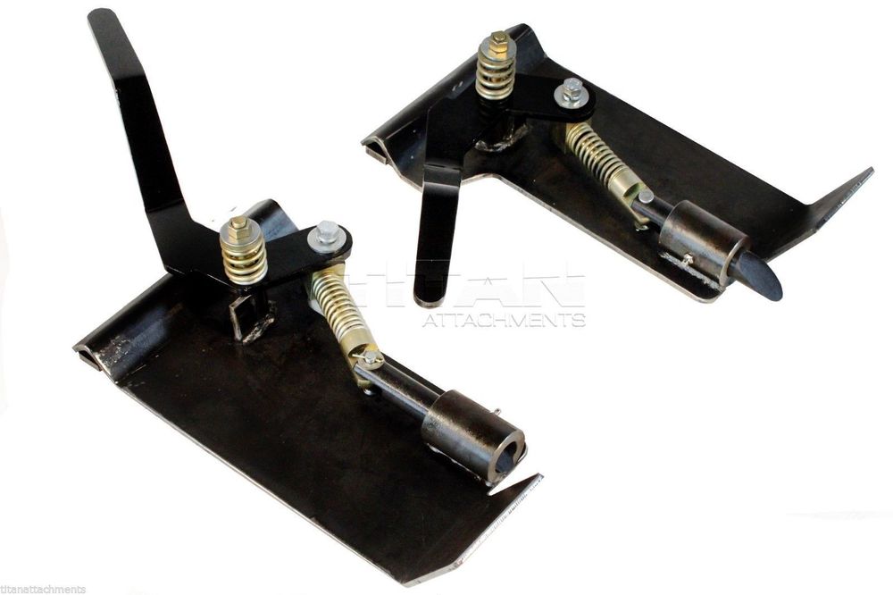

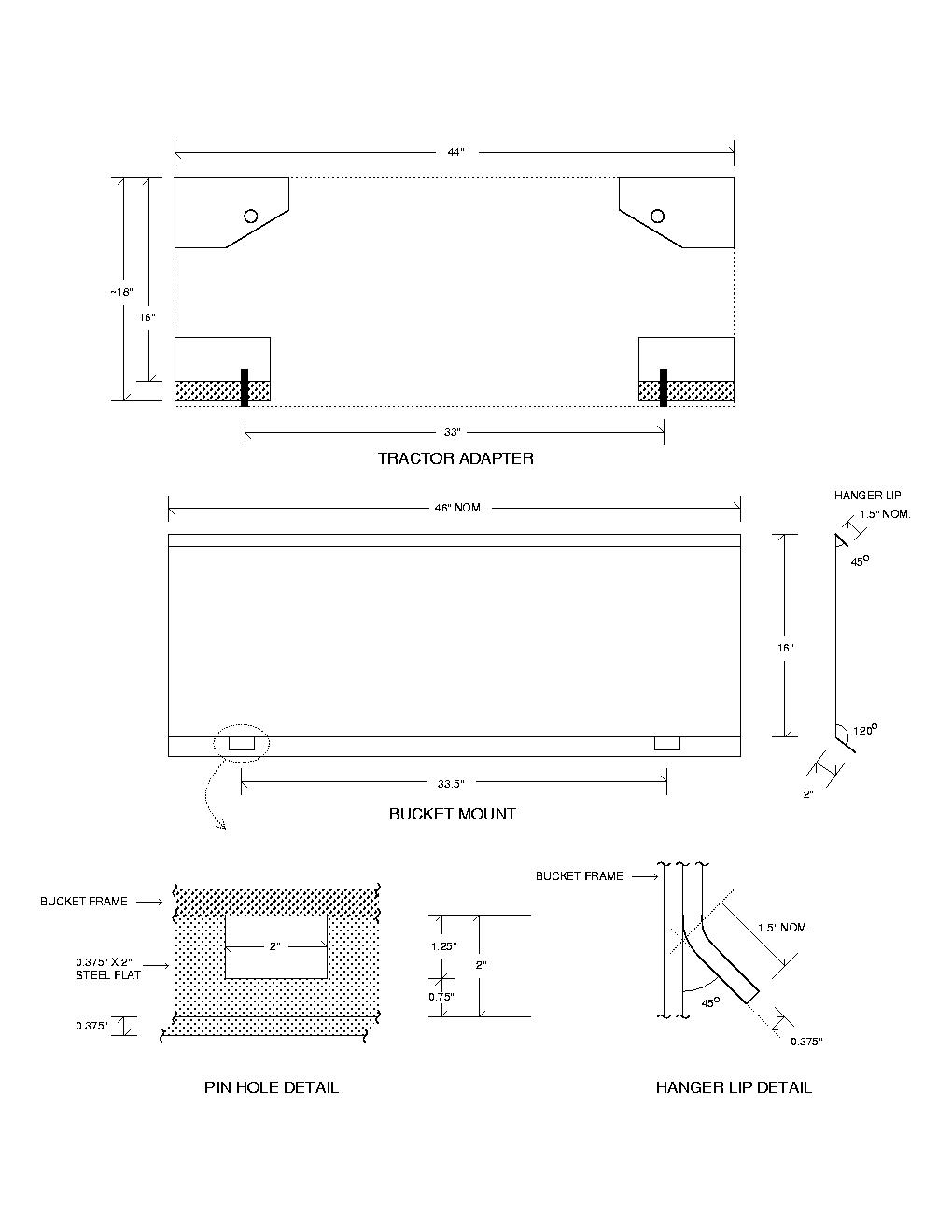

This side is what he wants.
If it is in there junk pile, I don't think I would want it.
That's the side I'm talking about.
They may have removed it because the pivots were wore out where it attaches to the skid steer arms on the loader. You don't use the pivots when you retrofit it for a tractor anyway as you make your own brackets.
I've bought two of them and they work great.
   / Skid-Steer Quick-Attach Mount (Male Loader Side) #12

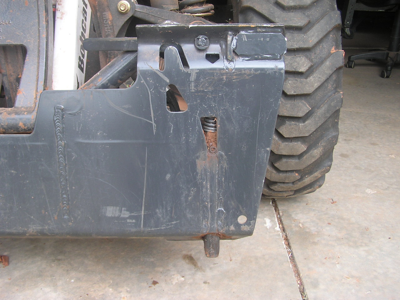

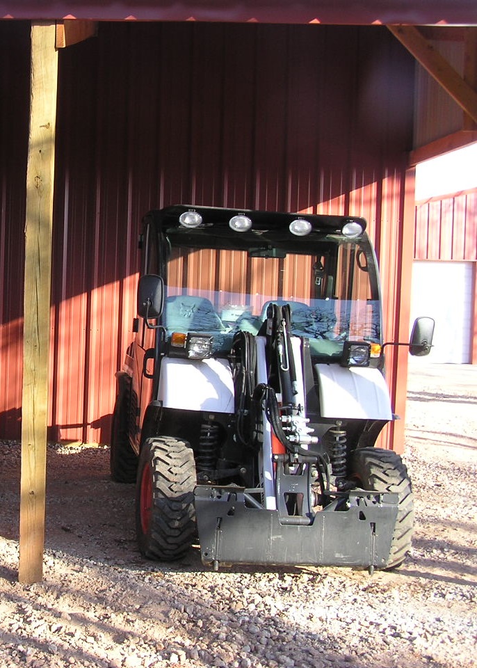

OK, it would look more like the SSQA on my wife's Toolcat.
   / Skid-Steer Quick-Attach Mount (Male Loader Side) #13
yes very similar. I ground the back side flat and then welded all new brackets (a friend cut them on their CNC plasma table) on the back. Basically converted a John Deer tractor to accept skid steer attachments on the FEL which is sweet! Any skid steer attachment that doesn't require hi-flow I can now use on the tractor.
I'm making the same thing but will go on the 3-point on the back. Using a skid steer male quick attach. So then if I put my skid steer forks on the back and use a hydraulic top-link I'll be able to not only raise and lower the forks but I can tip them too. Since the 3-point will lift a lot more than the FEL I can use it for the really heavy stuff.

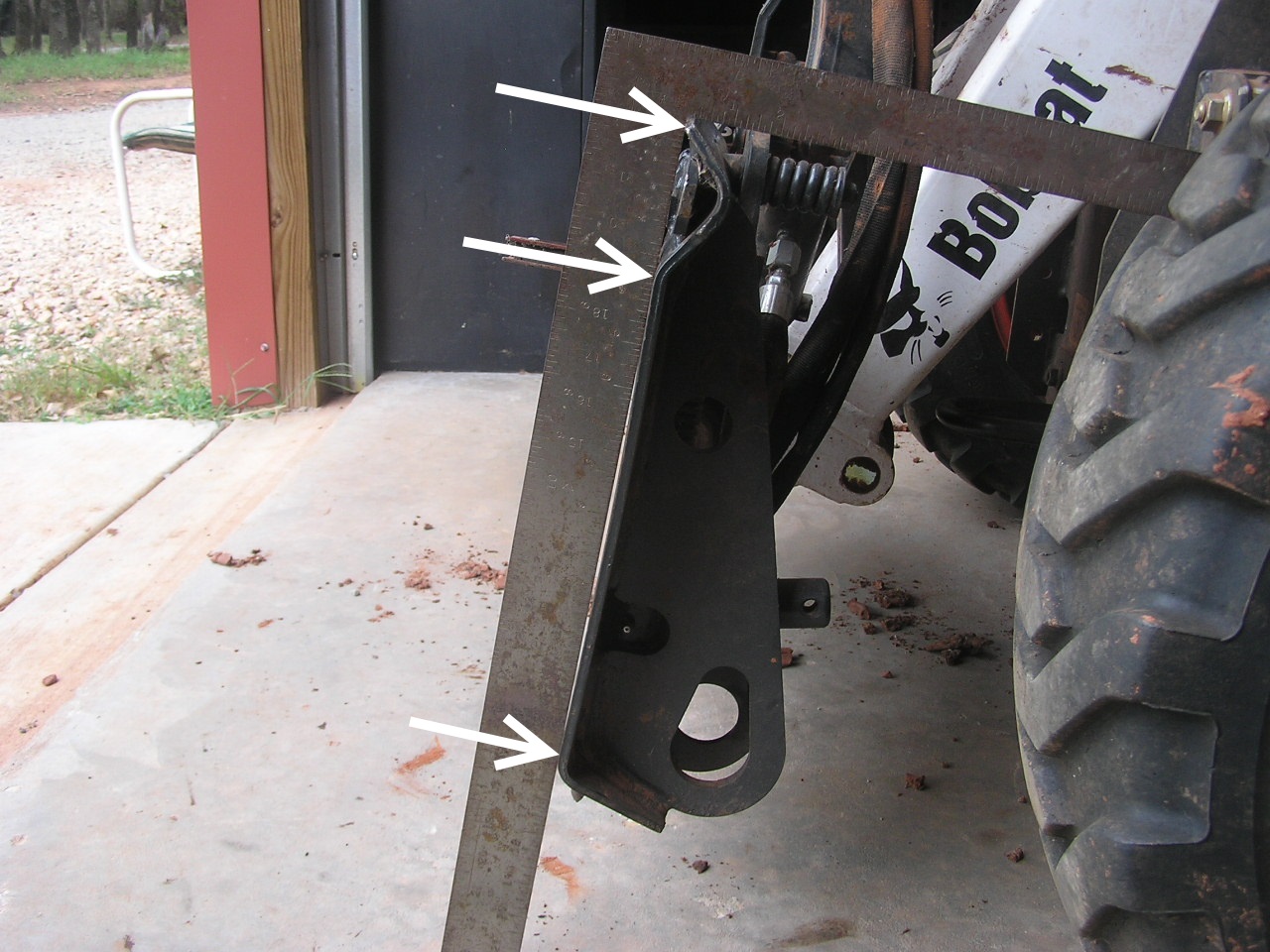

SSQA measurements
