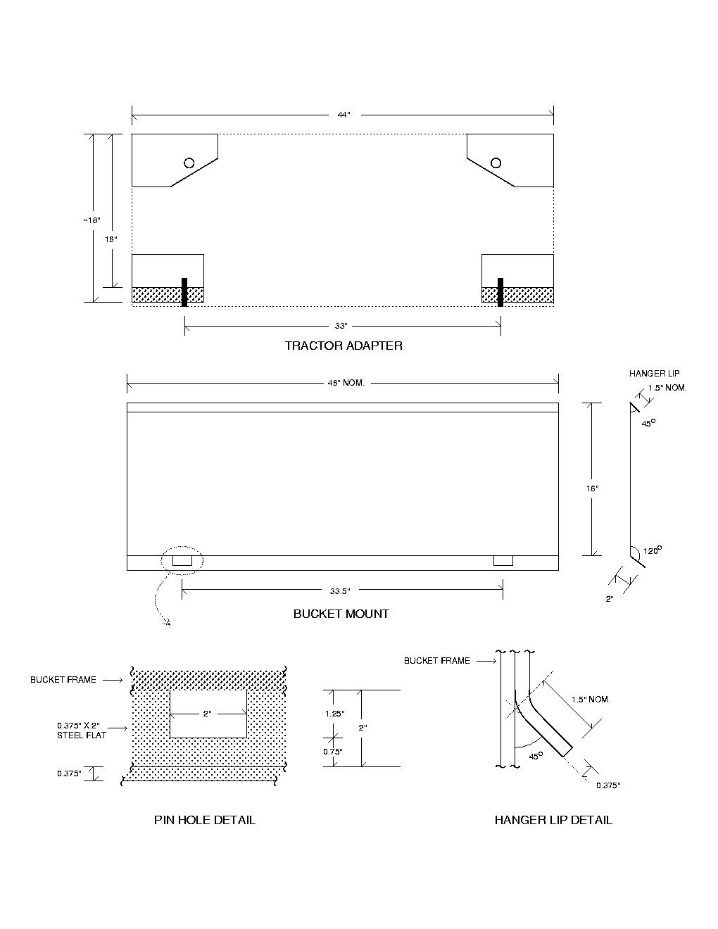

I have a tractor that uses the skid steer quick attach mounting system on the end of the loader. I want to make a snow plow for the tractor similar to this one HERE . I can buy a quick attach plate for around 200 beans but they look so simple to make. I don't have the exact dimensions. I need a one that looks like THIS .
Does anyone know where I can find the specs of the plate? The plan is to buy a old Meyers, Weston, ect snowplow from a truck, and adapt it to the plate. Should be a fairly simple project. If anyone has any similar experience doing this, I'd love to hear any suggestions also.

Hope this is what you are looking for. SAE J2513 standard.

That should work. Thank you very much!
